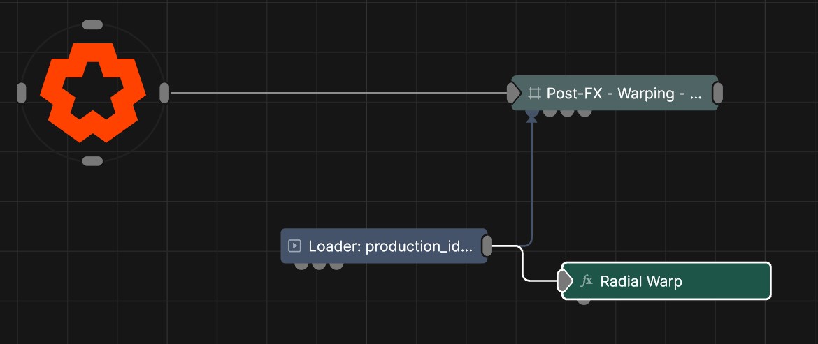

This node warps the screen radially around the center point.
This node warps the screen radially around the center point. The warp is performed with chosen number of iterations. The iterated warp points are summed over distorted area around the original warp point, respecting the given distort configuration parameters. Additionally, a chromatic aberration can be enabled for the warp operation. The chromatic aberration spreads the colours of the source image around the iterated distortion.
