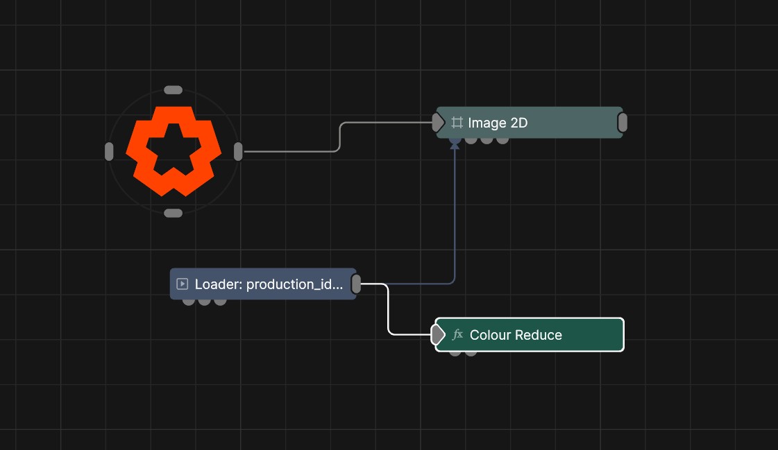

Set the amount of distinct colour in the image.
This node allows you to set the amount of distinct colours in the image by either quantizing the colours of the source image, or using the colour ramp input to define the amount of colours, as well as what colours they are.
