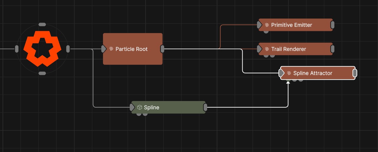

This node attracts particles towards a spline shape. The particles will flow along the spline towards a goal point which moves from the beginning to the end of the spline at a rate determined by the Spline Rate parameter. The splines used by this node are extracted from a 3D object which must be connected for this node to have an effect. If The object that is connected contains no spline data this node will have no effect.
This node requires a spline to be connected via the spline input.
