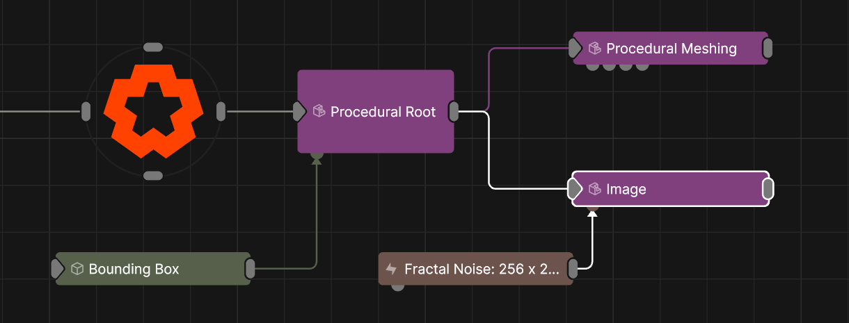

Genreate a Procedural shape from an image.
This node generates a distance field by using the luminance of an input image as a mask to generate a 3D extrusion of a 2D image.
Mode How the node uses the image data.
  • Heightmap : Use the image luminance as the height of the procedural.
  • Mask Shape : Masks the image based on luminance and then fully extrudes.
Texture The image used to generate the effect.
Colour Texture An image from which to read and output colours values, for procedural renderers that support it. this is only visible when the alpha values of the material colour property is less than 1.
Height Scale Scales the thickness of the generated shape.
Wrap Mode U Change how the image wraps around the the u axis.
  • Clamp : The edges of the image are extended to fill the space left by the transform.
  • Repeat : The image is repeated until if fills the space left by the transform.
Wrap Mode V Change how the image wraps around the the v axis.
Power Applies a power curve to the height value, to control steepness.
Profile The profile of the edges created by the generator.
  • Square : Generated edges will be square.
  • Circular : Generated edges will be circular.
  • Octagonal : Generated edges will be octagonal.
Filled Indicates whether the procedural should be filled in, or should be generated as outlines only.
ImageThe image used to generate the distance field.Video Loader
