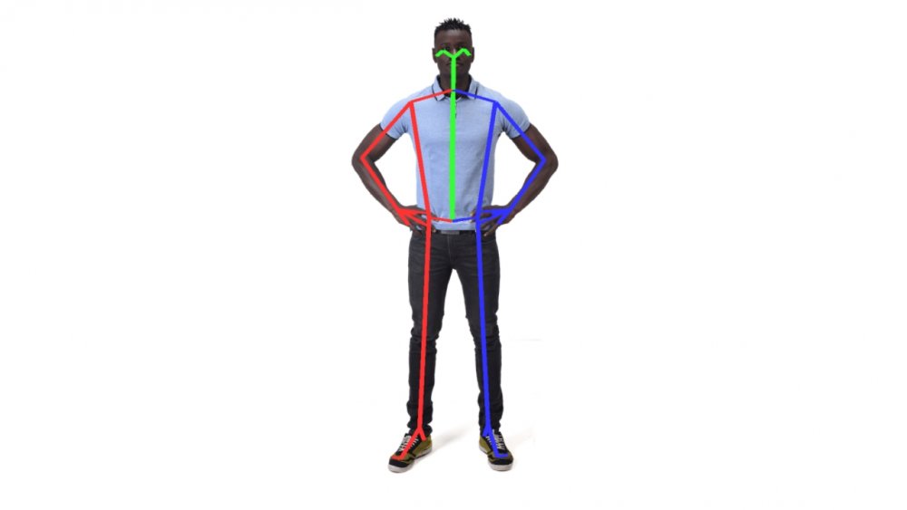

This node utilises the NVIDIA Broadcast SDK running on the NVIDIA RTX GPUs to pick out human forms from video, then generate and track 3D skeleton of their body. This technology may eliminate the need for physical motion capture suits in some circumstances.
It is only capable of tracking a single body at present. The tracker operates in both 2D and 3D space, but Notch makes use of the 3D data only. For best results, the camera should be as straight on as possible and the input video should be of suitably high resolution; 1080p is ideal.

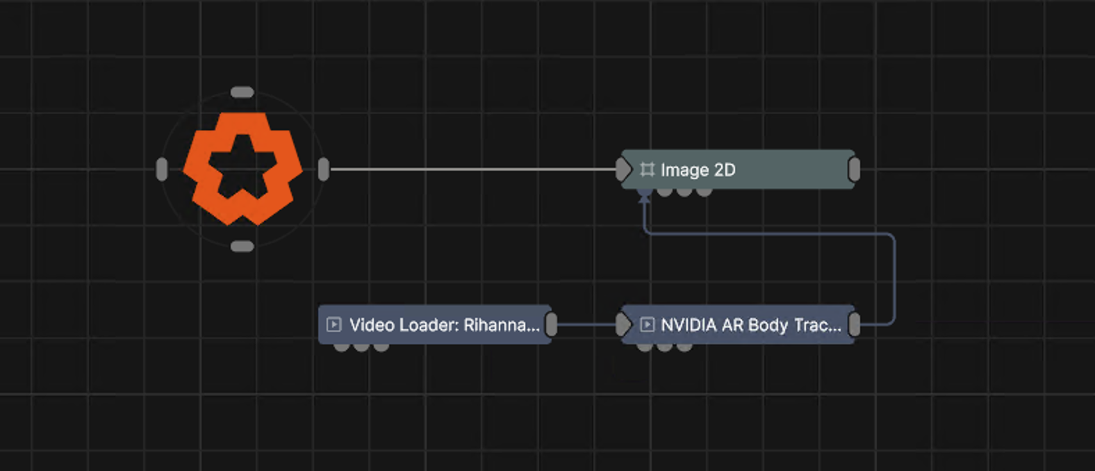

This node is designed for use with the NVIDIA AR Body Tracker Skeleton, which is able to apply the tracked skeleton data from this node to a 3D motion capture rig.
