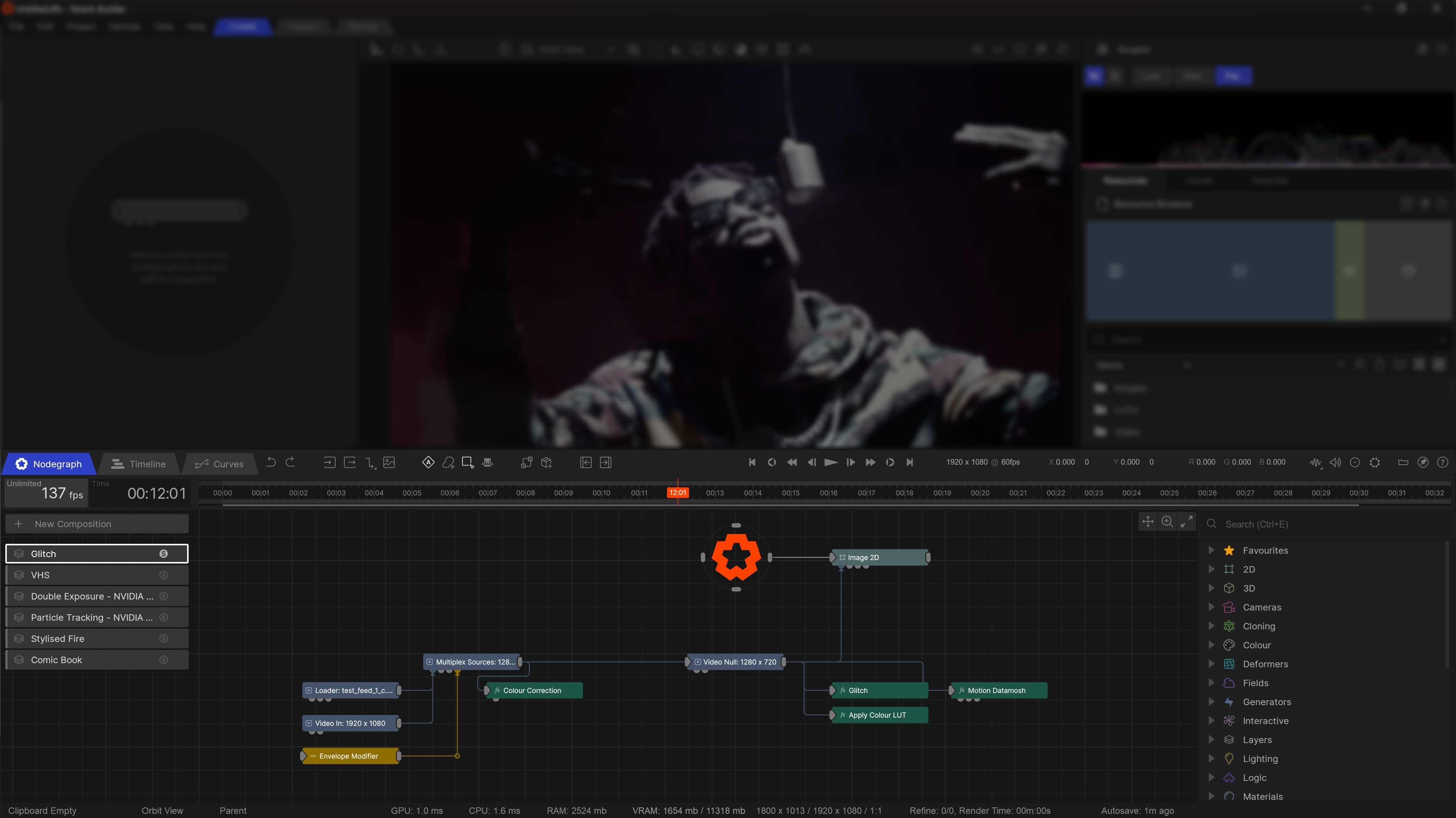

The Nodegraph is the main scene view for creating and combining the nodes in Notch. From here you can combine the different node systems together to create your render.
The Graph #
Where the magic happens. Every node which makes up your scene exists in this nodegraph.
The Nodegraph has a number of tools available to make putting nodes together as easy as possible.

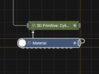

Node Alignment #
Nodes will align themselves with the other nodes in the scene, drawing red matching lines as they go.

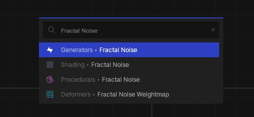

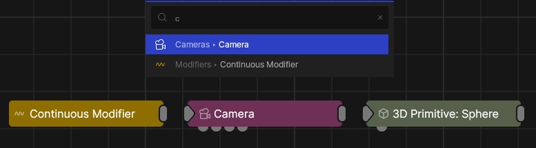

The floating search (Shortcut Ctrl+Space) allows you to search for any node in the node list, and add it into the Nodegraph. Double-clicking the left mouse button on empty space in the Nodegraph also opens the Floating Search panel for adding nodes.
floating search

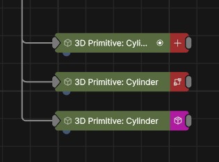

Embedded Nodes and Assets #
Nodes can be embedded into other nodes, for clean up or as a stepping stone in building assets. Hit the plus icon to expand and contract.
For more information on Embedded Nodes and assets, check out Assets and Embedded Nodes.

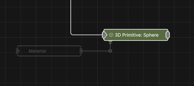

Hints #

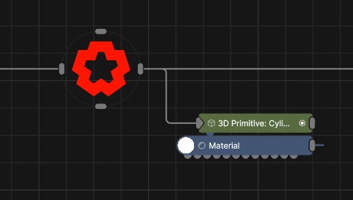

Hints allow you to quickly build up a nodegraph by suggesting commonly connected nodes to be added right away. Clicking on the node will automatically add it to the nodegraph. Deselecting the node will no longer show the hint. To see the hints again for a node, simply double click the nodes output.
hints

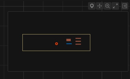

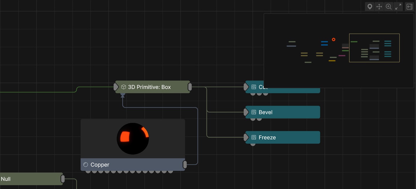

Minimap #
The minimap provides a compact, simplified overview of your nodegraph, displaying nodes without connections or labels. Click to pan, scroll to zoom, and right-click to access size and position presets or hide the minimap. The inner rectangle represents the viewing area of the larger nodegraph.
