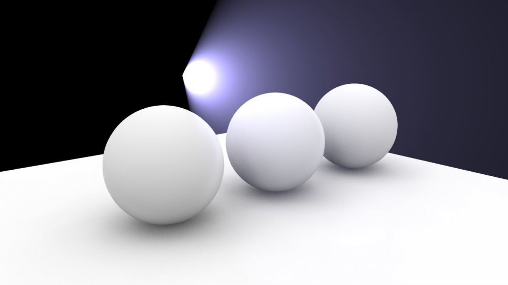

Generate a simple light beam.
This node generates a simple light beam, visually similar to what is achieved when Scattering Intensity is used on a Light, but without contributing any actual lighting in the scene.
This does not emit light, will not affect surfaces adjacent to it or cast shadows.

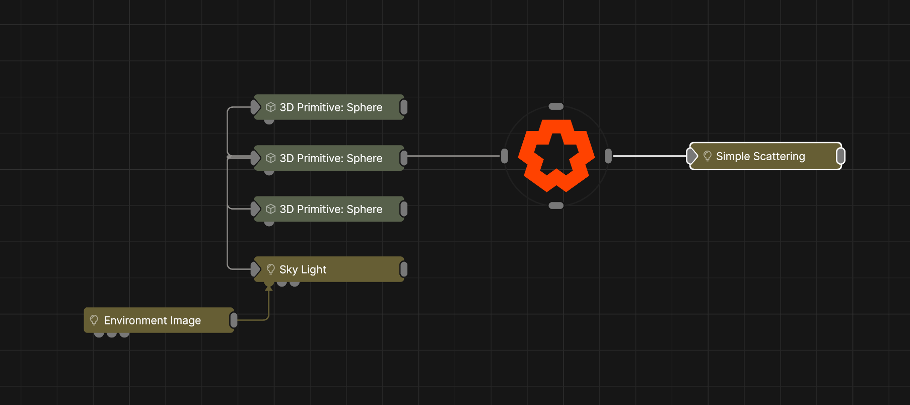

Mode Change the shape of the light.
  • Sphere : Light is emitted from a sphere.
  • Cone : Light is emitted from a cone.
Brightness How bright the light is.
Max Brightness Maximum brightness the light can reach.
Colour Change the colour of the light.
Cone Angle Change the angular area of light emitted from the light. only functions with “cone” selected in the mode attribute.
Sort Bias Biases the draw order of the beam against other transparent items in the scene.
Depth Test Enabled The scattered light is depth tested against objects in the scene.
Use Geometric Bounds
Invert Cone Direction Invert the direction of the cone.
Dither Enabled
