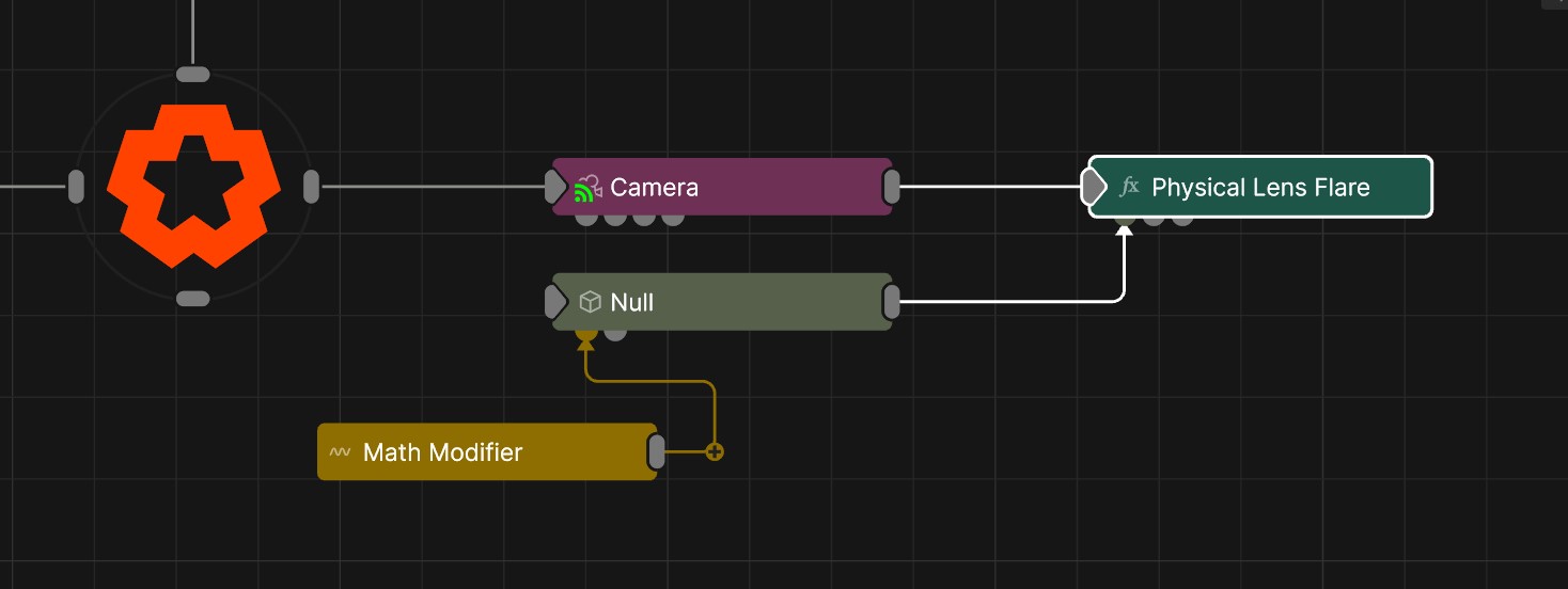

Add a physically correct lens flare reflections and a starburst flare to the scene.
This node simulates a lens setup to generate physically correct lens reflections and a starburst pattern from a given 3D transform point.

Transform NodeControls the position of the flare in the scene.Null
Lens Dirt ImageTexture map to simulate dirt on the lens.Video Loader
Starburst Dirt ImageTexture map to simulate dirt on the starburst.Video Loader
