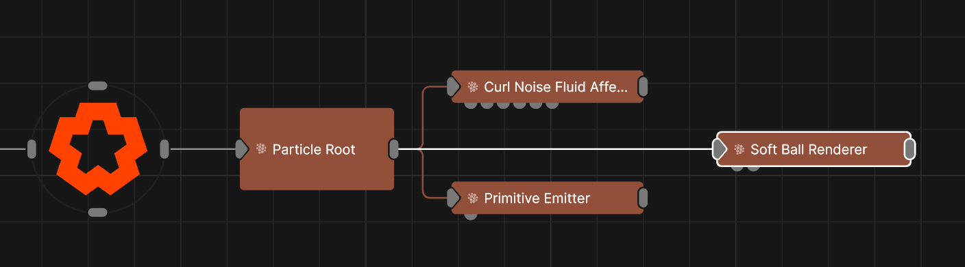

Renders particles as soft body spheres.
This node uses an approximated soft body simulation to render particle as soft spheres. The spheres can interact with each other softly, like spherical soft bodies, and also be constrained by collisions using particle collision affectors such as the Primitive Collision Affector.
This node generates geometry for each particle and can accumulate lots of geometry very fast when using a lot of particles. To reduce the amount of geometry generated, either lower the “Num Particles” in the Particle Root node, and / or reduce the amount of "Subdivisions" in the Soft Ball Renderer node.
