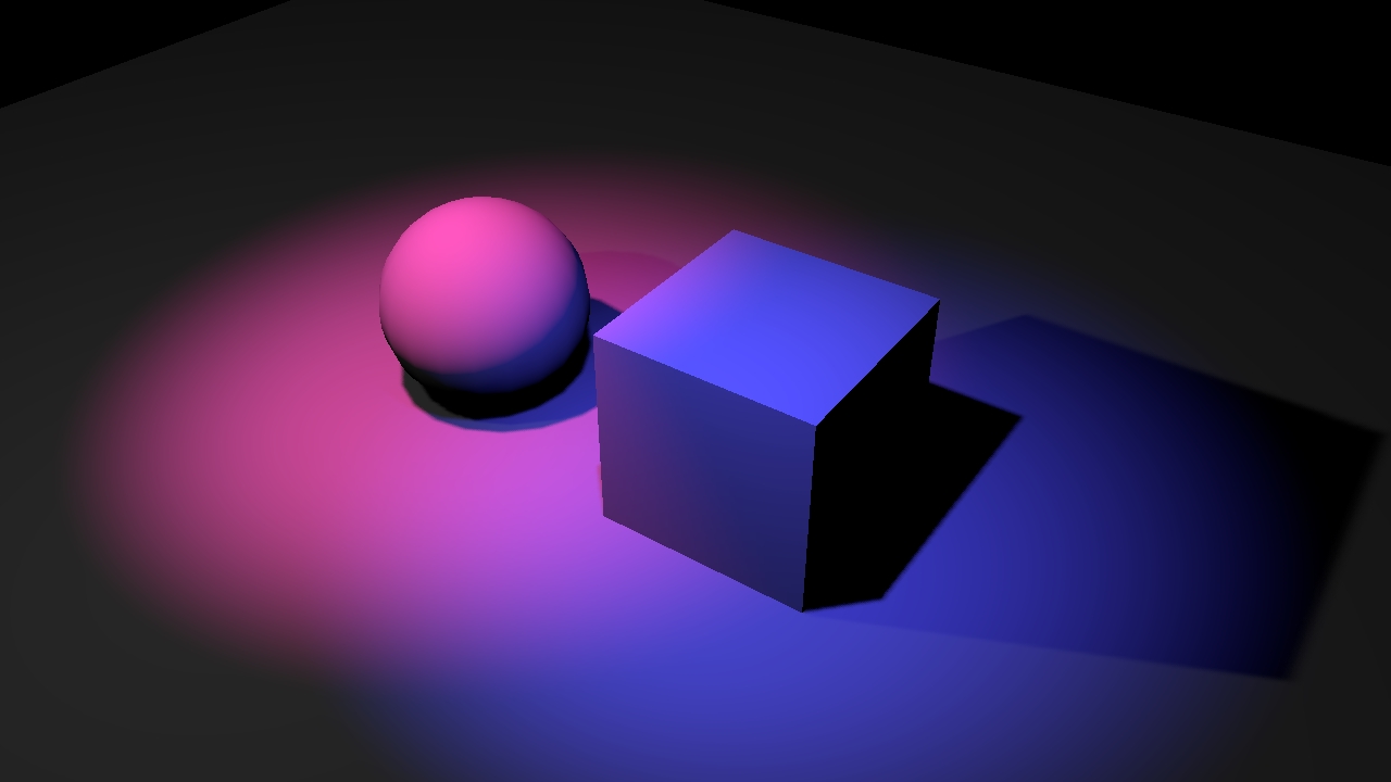

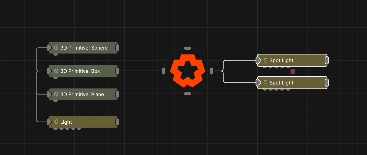

Add a Spot Light
Add a Spot Light node into the scene.
Attach the Target Node input to any object, to have the light track that object.
