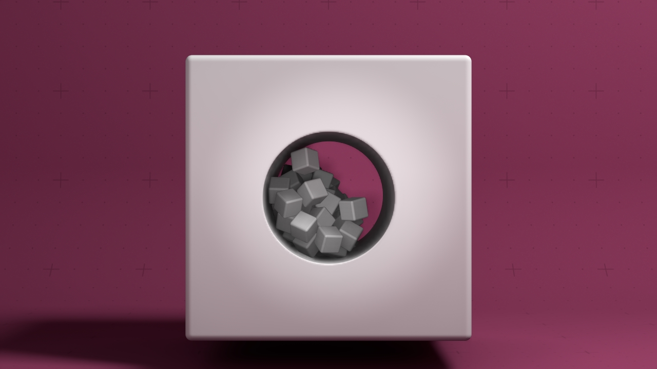

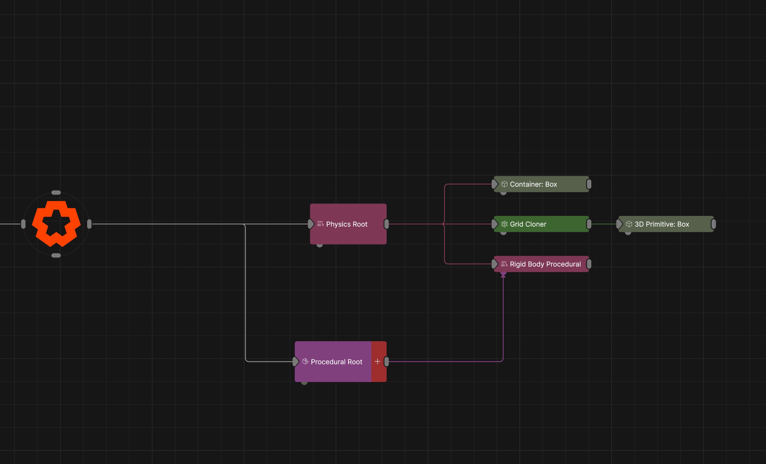

The Rigid Body Procedural node allows a procedural system to be used as a collider for rigid bodies. It must be parented to a Rigid Body Root. This node is great for getting complicated physics interactions at high frame rates.
These properties control the physical properties of the rigid bodies, changing how each object interacts with one another.
Advanced TODO
Procedural RootThe root node of a procedural system to use as a collision surface.Procedural Root
