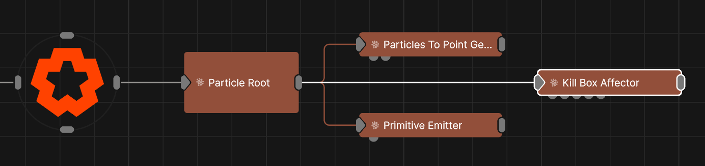

Kill Box Affector
Kill Box Affector
Remove particles from inside or outside a zone.
This node kills particles that are either inside or outside of a bounding box, dependent on the Kill Mode attribute. Particles can be killed immediately or decayed over a period of time depending on the Kill Operation.
