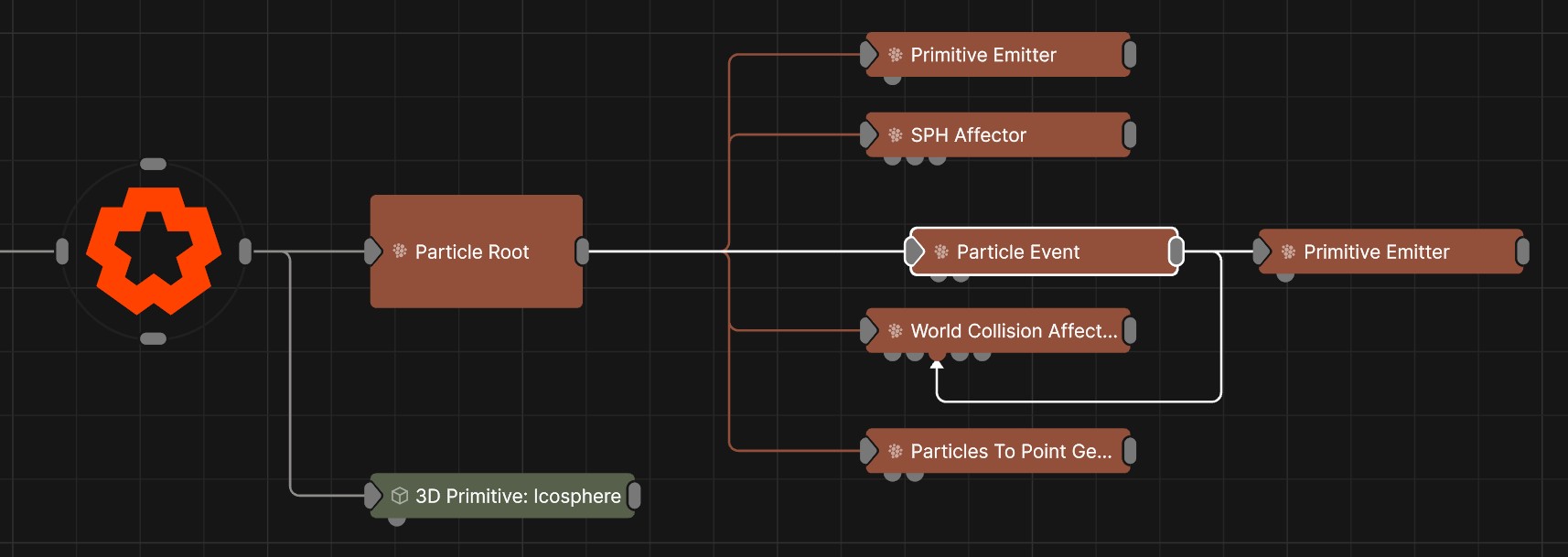

Particle Events are used to affect change in a particle system when something happens to an individual particle; for example, when a collision occurs between the particle and a collision surface, new particles may be emitted at that point; or when a particle reaches a certain age, it may change size and colour. Events are specified as a cause, set via the Cause Type parameter, and effect, set by the Event Type parameter. Particles are monitored for occurrence of the cause; when it occurs, the event is executed.
The Particle Use Amount parameter may be used to restrict the set of the particles so that not every particle for whom the cause occurs will trigger the event. For events which emit new particles or change particle materials there must be a Particle Emitter connected to the Target Emitter input.
The child of this node is the emitter which will be used to emit new particles from.
