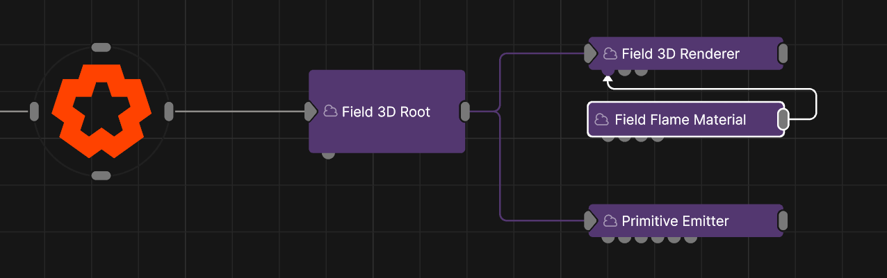

A 3D field material suitable for fire / flames.
A 3D field material suitable for fire / flames. The field density is used to control absorption and scattering, and the temperature of the field is used via black body simulation to output an emissive colour. The temperature is also used to control the opacity of smoke and flames: temperatures below the Smoke Max Visible Temperature value are rendered as smoke, temperatures above the Flame Visible Temperature value are rendered as flame.
The smoke and flame shading can be controlled separately with this material to some extent. The smoke opacity is controlled with the Smoke Density parameter. The flame opacity is controlled via the Flame Density parameter.
