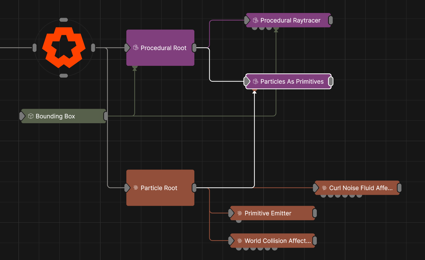

Particles As Primitives
Generate primitive shapes from particles for a procedural.
This node generates primitives based on the positions of particles from a particle system.
Particle Size Edit the size of the particles.
Size Randomness Add randomness to the size of the primitives.
Potential Cutoff Controls the blending range of every particle (how smoothly they are blended).
Use Particle Colours If this is enabled then the colour of each primitive will be taken from its particle. This only has an effect for procedural renderers that support colour generation.
Primitive Type Change the shape of the generated primitives.
Particle NodeThe particle root used to generate the distance field.Particle Root
