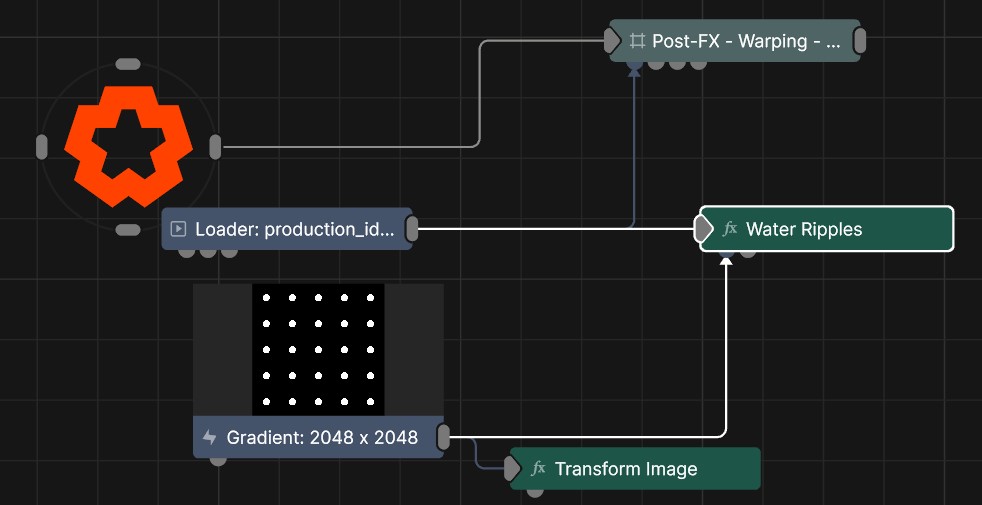

Simulate water on an image.
This node simulates water movements across an image based on an input field using a spring-based water solver.
Simulation Speed Control the speed at which the warp is animated.
Speed The speed of the ripples as the move over the image.
Length The distance between springs. Larger values make the ripples move faster.
Displacement Scale Scale the displacement the water ripples simulate.
Velocity Dampening Controls how much the velocities are dampened over time.
Brightness Controls the brightness of the ripple displacements composited over the image so they can be seen, giving a lighting effect.
Trigger Source Channel Choose what triggers and affects ripples.
Simulation Width The width of the grid used for the simulation, in cells.
Simulation Height The height of the grid used for the simulation, in cells.
Force Input FieldGreyscale input it determine the source of the ripples.Video Loader
Collision ImageCollide the water sim against an image, based on a luminance threshold.Image Plane
