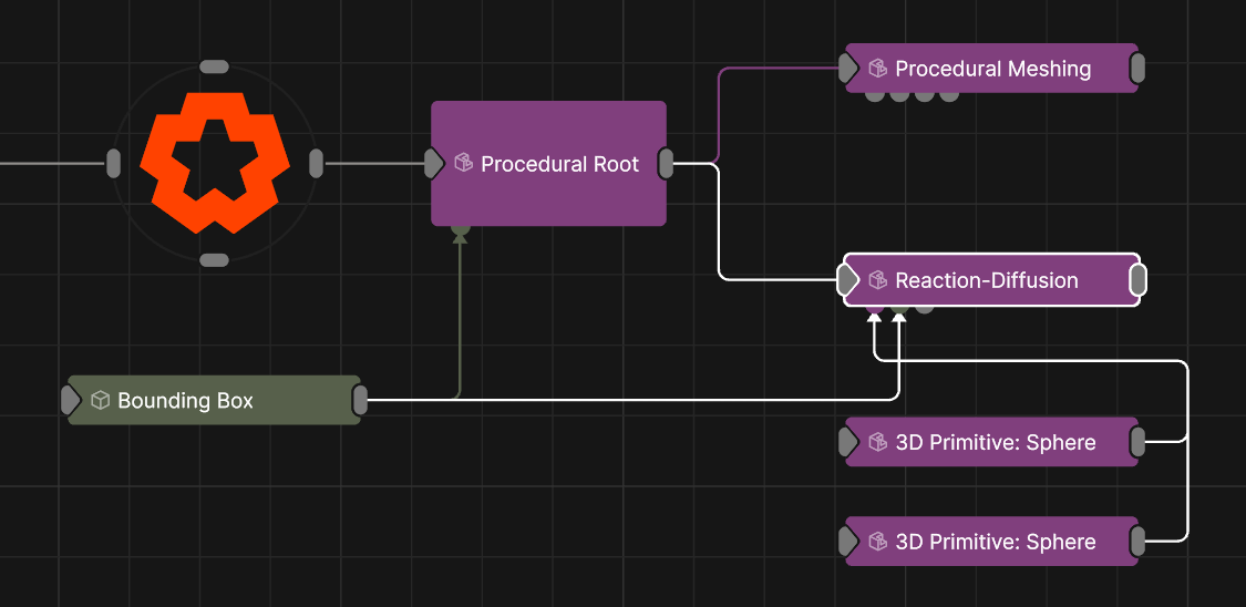

Performs reaction-diffusion simulation to a Procedural system.
Performs reaction-diffusion simulation, using a procedural input to restrict the placement of seeds and another procedural input to restrict growth.
This node simulates the Gray-Scott reaction-diffusion process, which can be thought of as a kind of fluid simulation with an extra step that creates organic-like patterns which grow out from seed points. Seed points are created by random spread, and if a seed restrictor is used then seeds outside of the restrictor volume are rejected. The growth is limited by the growth restrictor volume.
More information on the general topic of reaction-diffusion simulation can be found here.

Growth RestrictorRestrict the growth rate.3D Primitive
Bounds OverrideOverride the bounds.Bounding Box
Seed RestrictorRestrict where seed values can be positioned.3D Primitive
