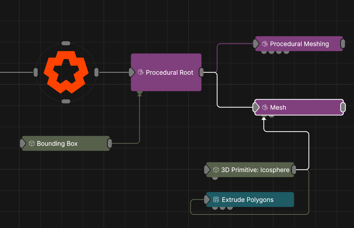

Mesh
Mesh
Generates a 3D Object for a procedural.
This node generates a distance field from a mesh object. Useful for converting a mesh into a procedural, as a basis for further processing.
