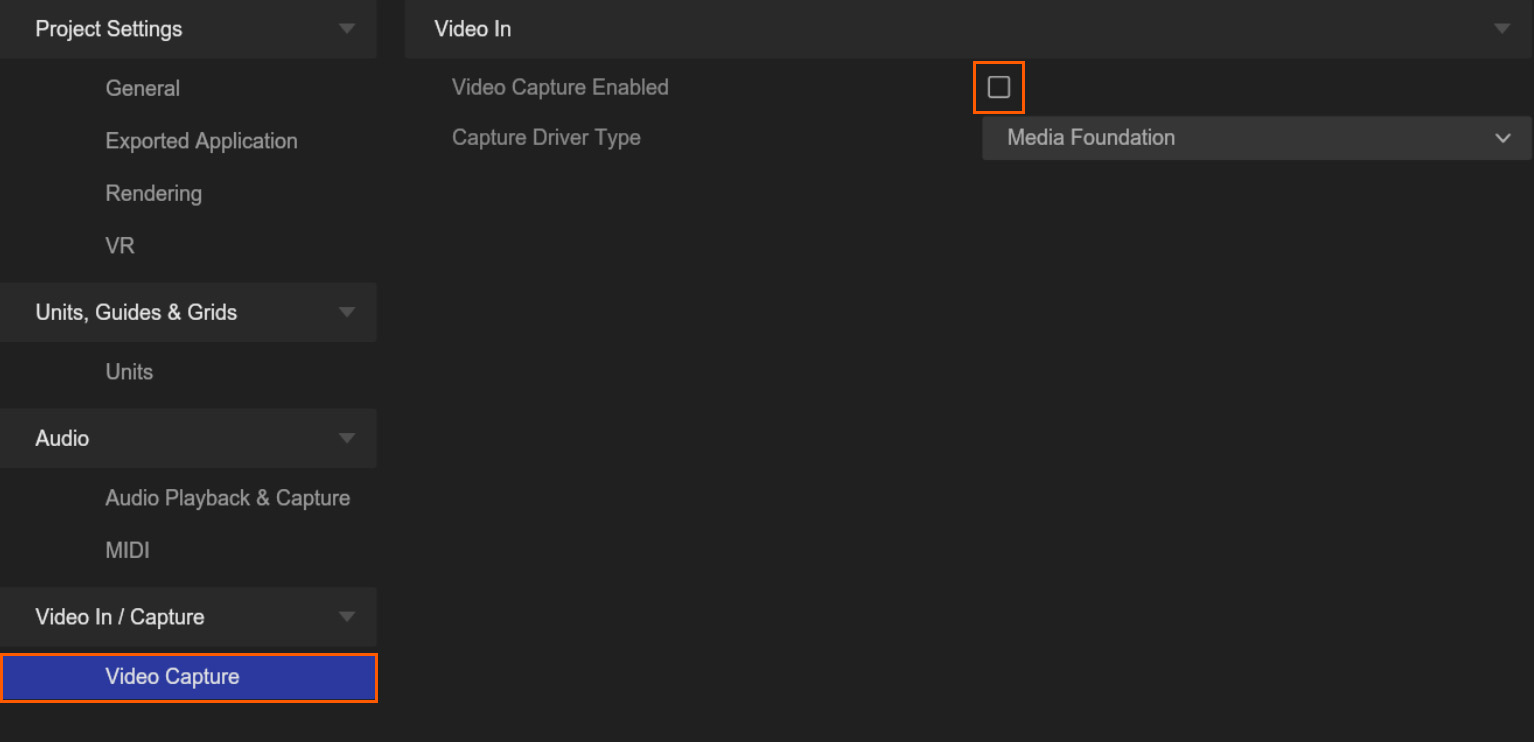

To do this, go to: Project -> Settings -> Video in / Capture.
Here is where you configure any live video input sources that you want to use in your project.
Activate video capture #
For this example select “Video Capture”. Video capture allows you bring in video from any device that uses either Directshow, or Media Foundation drivers. Typically this would be either webcams, or capture cards which could be used to feed in video from other cameras or video systems.
To activate video capture, click the “Video Capture Enabled” toggle.

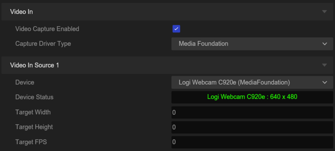

Select capture device #
Now you can select the relevant “Capture Driver Type”, and then your “Device”, which in the case of this example is a usb webcam.
You will see that once the device is successfully connected, the “Status” will turn green. If the “Status” is not green then this means that the device is not connected correctly, or is possibly in use by another program.

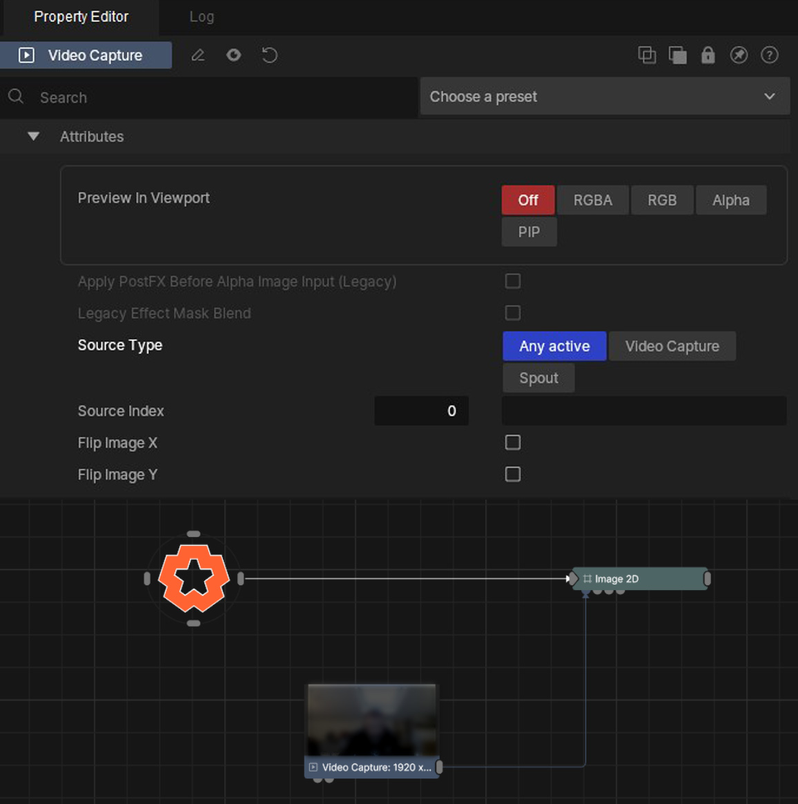

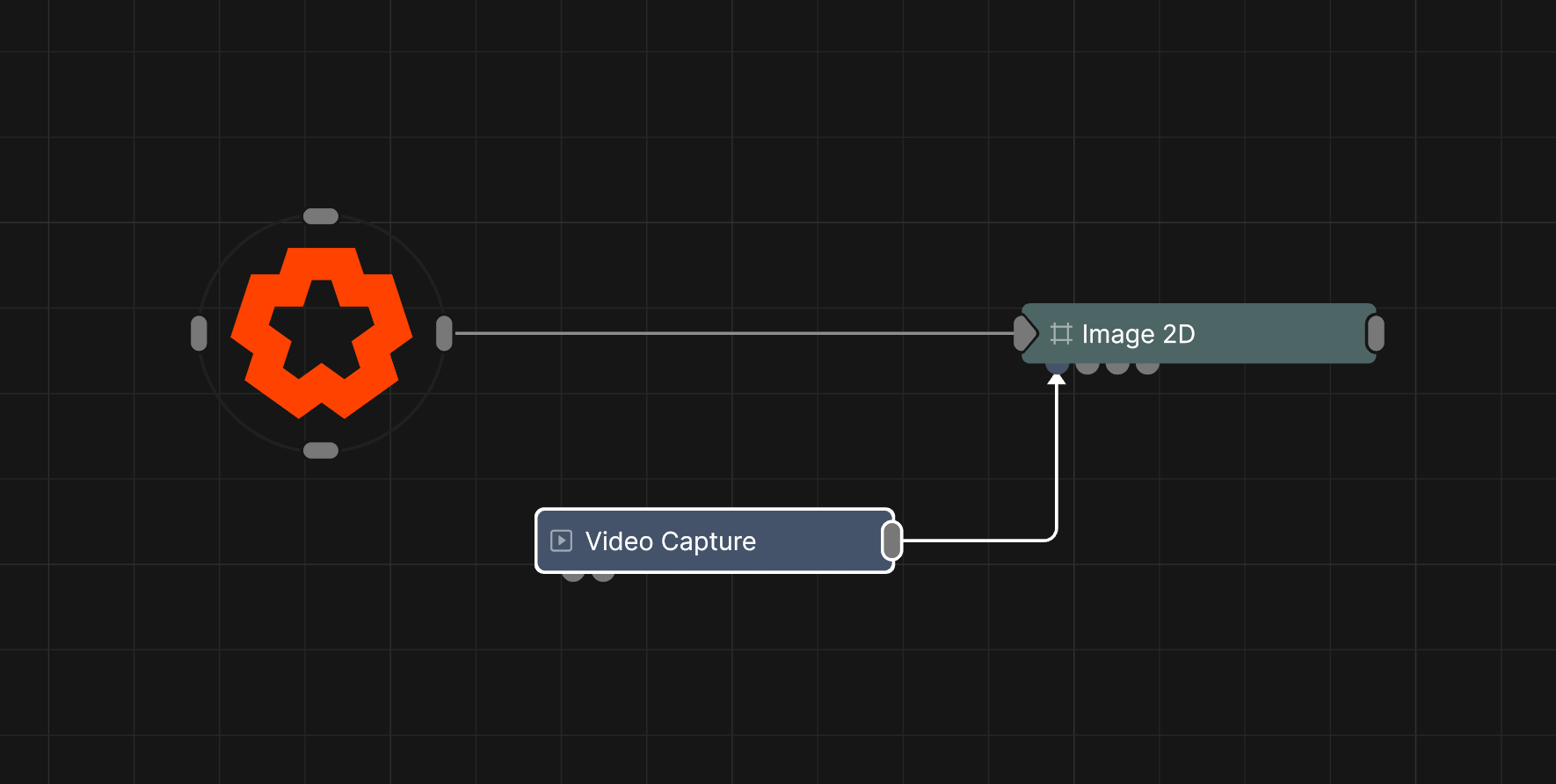

Once you have one or more video capture devices setup, can can now start to use them as sources in the Nodegraph. To do this you can use a Video Capture node. This node allows you to select one of the capture feeds that you set up in the project settings. As we have only added one capture device, we can leave the settings at default. This will select the capture device at index 0, which is the first slot in the settings, and also where we added the webcam as a device.
In this example I have also connected the Video Capture node to an Image 2D node, which will map the video feed to the viewport screen.

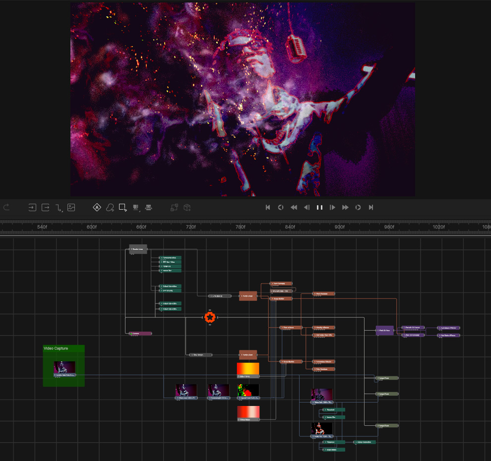

Now you have the basics of video capture set up, you can use the capture feed as a texture in many different ways inside Notch. Here is an example that uses the feed with a mixture of Post-FX, Particles and Fields to create a live IMAG effect.
