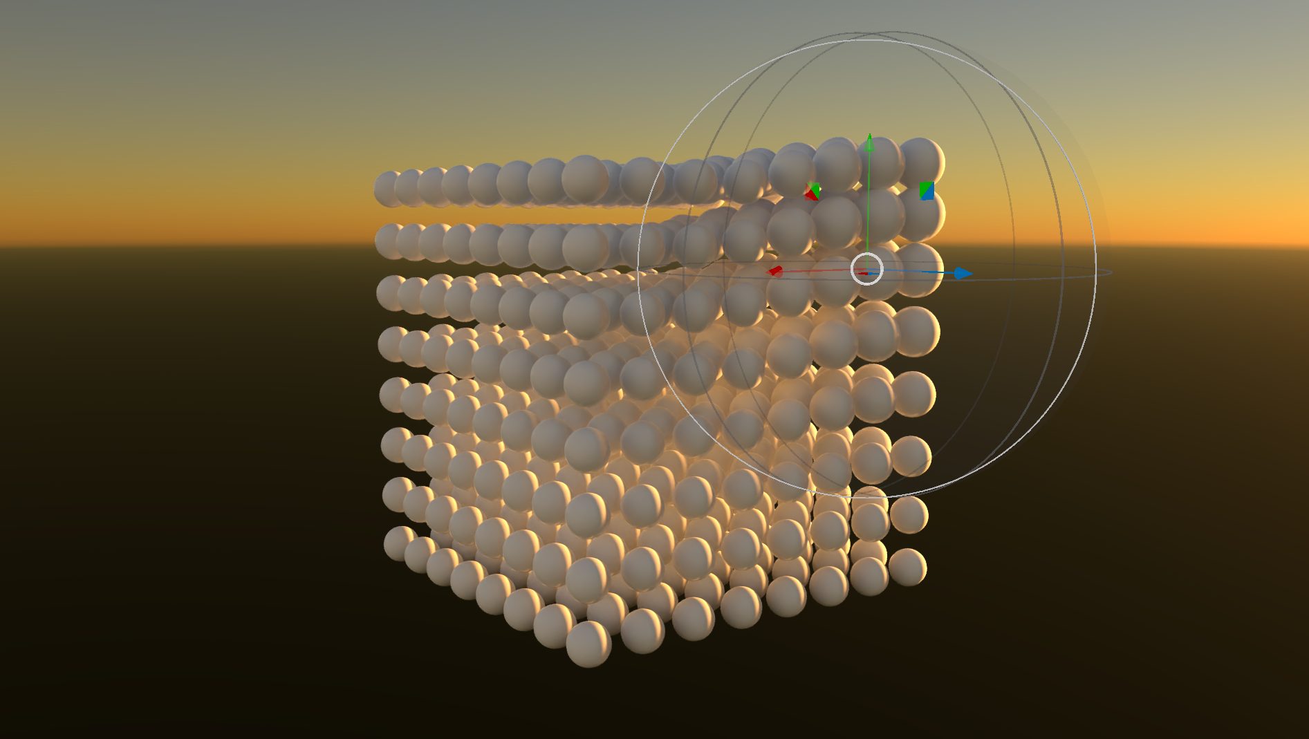

Cloner systems allow you to create cloned instances of 3D objects in a highly performant manner. 3D clones are rendered using hardware instancing on the GPU, so a huge number of clones can be instanced and rendered simultaneously in real time.
Many types of 3D Object can be cloned through cloner systems. Clones can then be animated through the use of effectors. These effectors can be used to alter and animate the position, scale, rotation and the material of the cloned geometry.
What this means is that cloners are a really easy, performant way of making dynamic content inside of Notch, compared to using many individual objects or nodes.

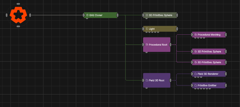

How to clone individual objects #

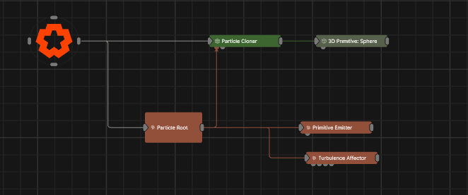

To start cloning an object is really straightforward. You just parent the object you want to clone to the cloner node. In a lot of cases, this is all you need to do to get your clones working.
In other cases, the cloner node will also need an input that determines where the clones will be placed. The image cloner, array cloner, mesh cloner, volume cloner, particle cloner, procedural cloner and spline cloner all need an input. This is because the node that is fed into that input will determine how the cloner works.
How to clone multiple different objects #
In much the same way as you clone a single object by parenting one object two a cloner, you can add more objects. You can add as many child objects as you like to a cloner, and the cloner will clone a mix of all of those objects.
The way these objects will be cloned and controlled is described below in the Node Spawn Mode and First Clone Sections.
Two things that can be really handy for cloning multiple objects are:
  • The humble Null. If you build something you want to clone multiple times using a combination of nodes, you can parent the whole system of nodes to a Mull, and then parent that to the cloner. This way, each clone will use the whole system that is parented to the Null.
  • Assets, especially Embedded Assets, can be really handy to do the same thing, but also help keep things tidy as you can contain a bigger system of nodes inside of one node.

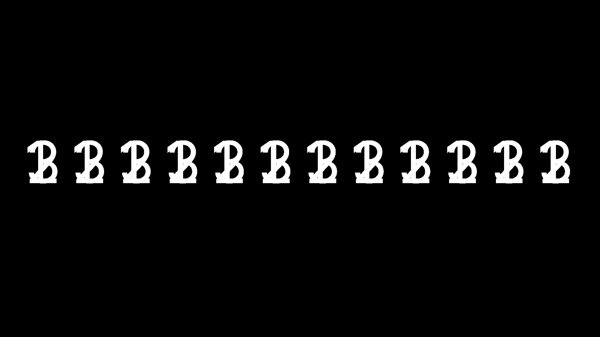

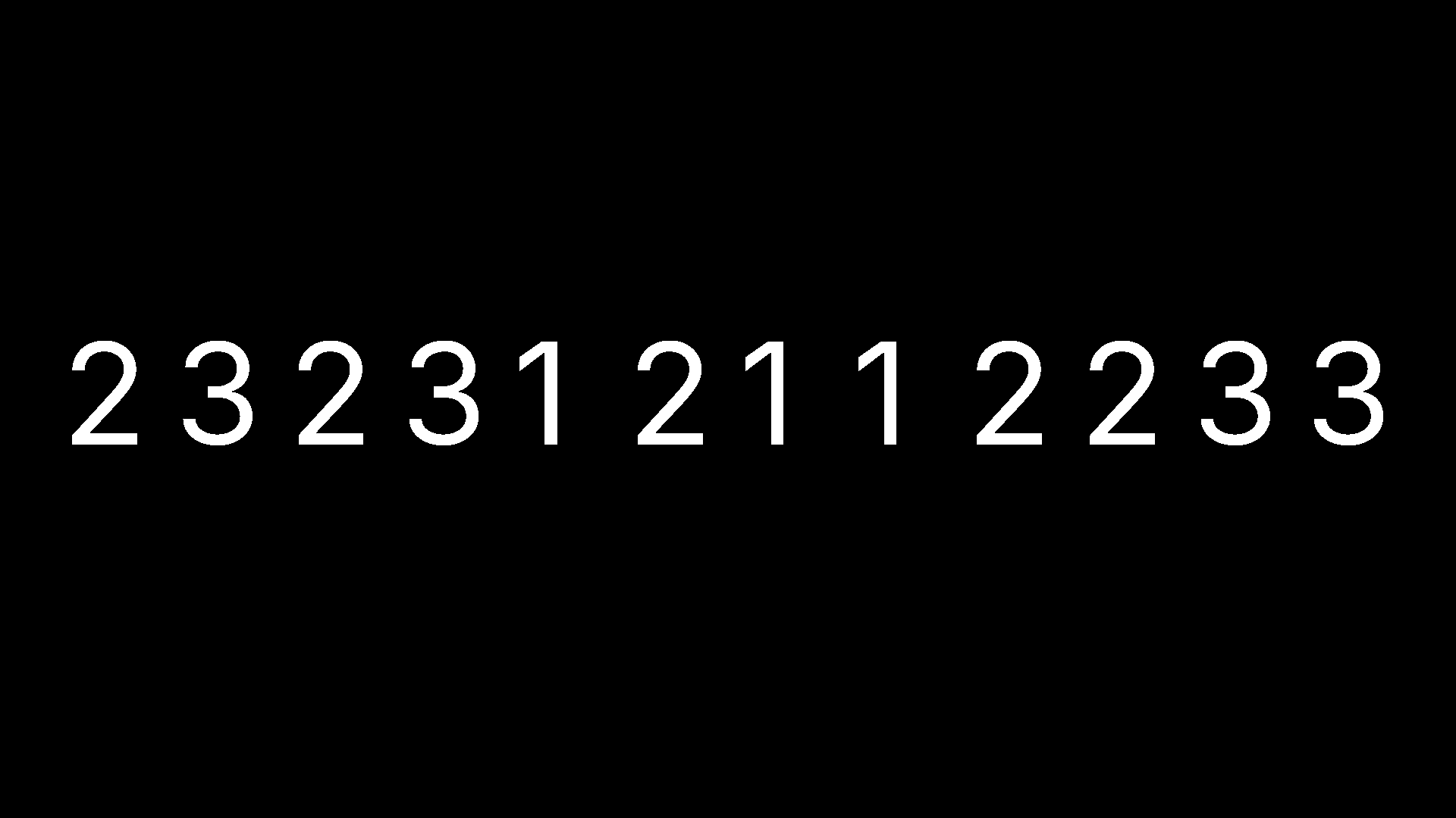

Iterative Spawn Mode Setting this to “Iterate” will assign each child of the cloner to each clone iteratively.
Random Spawn Mode Setting it to “Random” will assign a randomly selected child node at each clone position.
Random Spawn Mode Setting it to “All” will clone all children of the cloner at every clone position.
Remember that Notch sorts the node graph in a top to bottom, left to right order. This sorting is going to determine which order the clones are used in. The top node will be used as the first clone, the lowest clone will be used as the last clone.
If you want to change the amount that each individual object will get cloned, you can change the number of times it is parented to the cloner. If you parent one object to a cloner twice, and another object to the cloner once then the first object will be cloned twice as much as the second object.

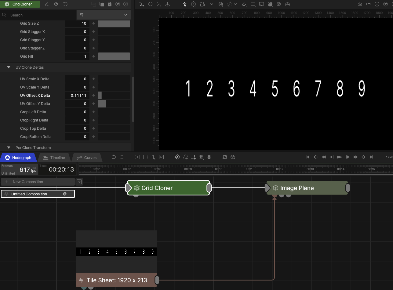

UV Clone Deltas #
This is a group of properties can be used to alter the way that materials are applied to each clone via the UVs. You can use them to adjust the scale, offset or crop the UV on each individual clone.
This can be really useful, especially when used with a tile sheet. If your clones are using a material that has tile sheet textures, you can give each individual clone a different texture.
As an example, if you use a 9x1 tile sheet across 9 clones, you can set the the UV offset to (1/9) and each clone will take a separate tile . What’s useful about this is that even though the geometry is cloned (and so really performant), you can still apply individual textures to the clones.
Tile Sheet

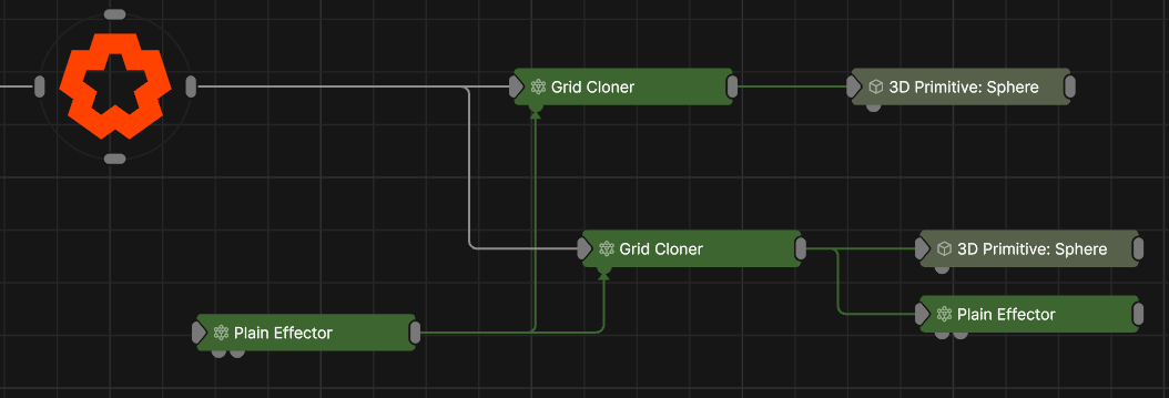

Clone effectors can be connected in two different ways:
  • The effector can be parented to the cloner node. This can be really useful because the clone effector will move with the cloner itself by default.
  • The output pin of the effector node can be connected to the effectors input pin of the cloner node. This can be useful as it can let you move the effector independently of the cloner by default.
Effector Connections
You can connect one effector to multiple cloners, to make one effect apply to separate cloner systems.
