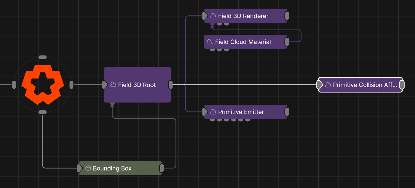

Allows fields to collide with primitive shapes.
This node allows fields to collide with the surface of primitive 3D shapes. The field will flow around or bounce off the shape’s surface and be prevented from entering it.
