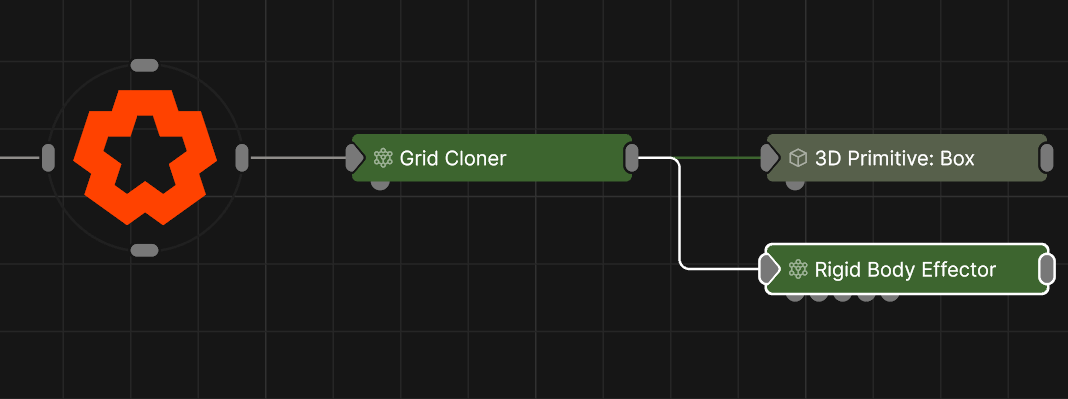

Applies a rigid body simulation to a cloner system.
The Rigid Body Effector node turns clones into rigid bodies. The resulting bodies are able to collide with each other, or with other bodies that are part of the same physics system - under the same Rigid Body Root.
If this node is parented via a Rigid Body Root it will be part of the physics system of that Rigid Body Root. Otherwise, this node is capable of acting as its own physics system, allowing for easy rigging of a simple physics system with a single cloner.
For best results ensure that the clones do not overlap in their initial position before dynamics is applied.
Unlike other cloner nodes, this Effector is a simulation node. This means that jumping in time will not produce predictable results, as the simulation needs to process the frames in between.
