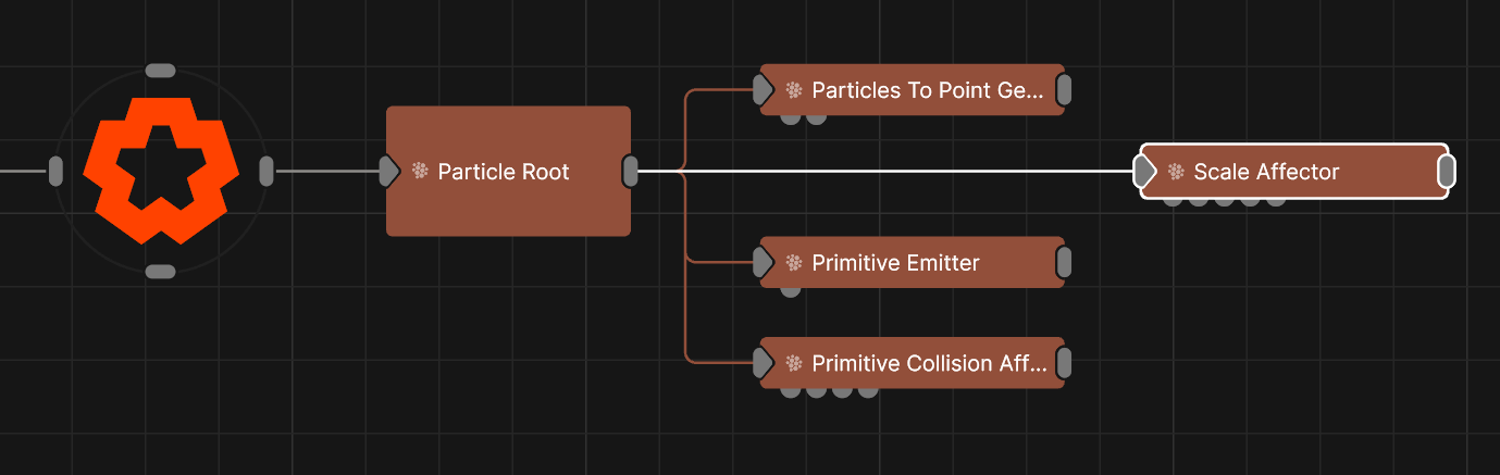

Scale Affector
Scale Affector
Apply changes to the scale of particles.
This node changes the scale of particles as they enter its falloff region.
