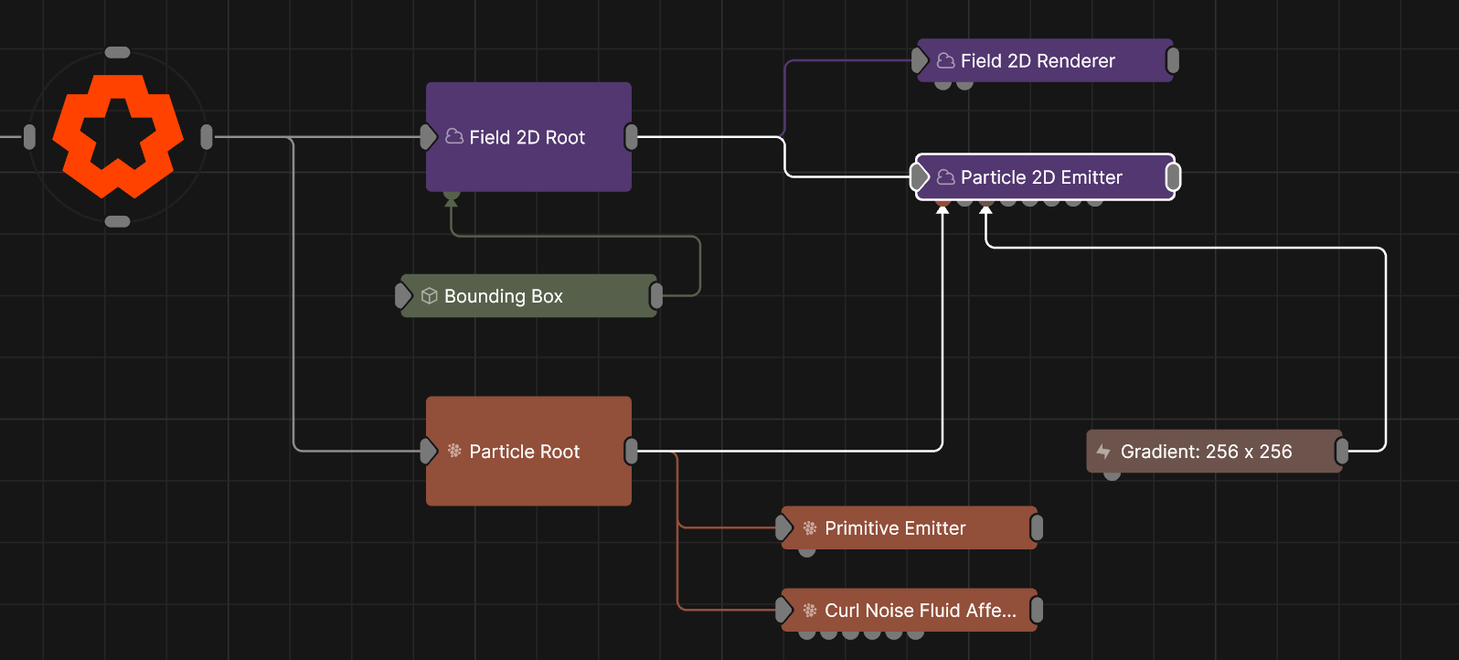

Particle 2D Emitter
Particle 2D Emitter
Emits ink into a field from particles.
This node generates colour/ink based on the positions and movement of particles from a particle system. The particles contribute both ink and velocities to the field.

Particle NodeThe particle root used to generate the field. A particle system must be connected for this node to function.Particle Root
Sprite Transform NodeApply the transforms of another node to this node’s particle sprites, relative to its parent.3D Null
Image NodeImage or video to apply to each particle spriteVideo Loader
Density NodesShading node input for controlling emitter densityFractal Noise
Temperature NodesShading node input for controlling emitter temperatureFractal Noise
Fuel NodesShading node input for controlling emitter fuel amountFractal Noise
Colour NodesShading node input for controlling emitter colourFractal Noise
Velocity NodesShading node input for controlling emitter velocityFractal Noise
