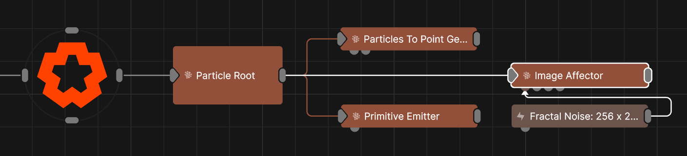

Image Affector
Image Affector
Attract or repel particles from an image.
This node is used to attract or repel particles from pixels in an image. This is typically used to make particles form into a given image. The image can be set directly using the Image attribute or connected from a video node via the Video Nodes input.
The image is pre-processed to determine which pixels should be used to attract or repel from by thresholding either the alpha value or luminance value.
This node requires a video node to be connected via the video nodes input.
Image Override the input image with an image selected from the drop down menu.
Flip Image How much the particle colours adapt to the image colours.
Dampening Add a gradual reduction in velocity over time after velocity is applied.
Inner Radius The radius up until which the affector is fully effective.
Mode Choose how the image affector affects the particles.
  • Repel : Particles move away from the node.
  • Attract : Particles are moved toward the image affector, and generate an image by colliding with the image plane.
  • Displace : Displaces the particle based on the luminance of the image.
Force Mode How the sampled force is applied to particles.
  • Set Velocity : Replaces particles motion outright.
  • Accelerate : Add the force to the existing velocity.
Direction
  • Closest Distance :
  • Gradient :
Use Thickness Toggle whether to emit the particles on a 2d plane, or in three dimensions.
Thickness Change the thickness of the three dimensional area the particles can spawn in. Only functions if ‘Use Thickness’ is on.
Pixel Cull/Thickness Mode Change how the depth of the particle generation is calculated and which pixels are used by the affector.
  • Alpha Channel : Higher alpha values will have greater depth.
  • Luminescence : Brighter parts of the image will have greater depth.
Alpha Threshold Manage the threshold on where the particles will emit based on the alpha or luminance.
Wrap Mode How the image wraps past the edges of the image.
  • Clamp : Clamp values past the edge to the value of the pixel at the edge.
  • Repeat : Repeat the image once past the edge.
Image Colour Adaption How much the particle colours adapt to the image colours.
Avi FPS Change the frames per second the video is played at.
Time Offset Offset the time the effect is running.
Luminance Offset Scale Offsets the points on the image in the depth axis by their luminance.
How the image colours should blend with the particle colours.
Blend Mode Choose how the particle colours blend to the source colours.
Blend Weight Controls how much the result of the affector is blended with results from preceding affectors.
Video Nodeimage or video to be used as a source to emit particles from.Video Loader
