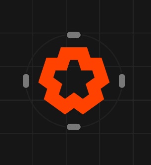

Root
Root
The Root node for the scene.
The Root node for the scene, controlling the basic scene setup and other important global scene attributes. All subsequent nodes in the Notch Project should be connected to the root to exist and contribute to the scene, either directly or indirectly.
