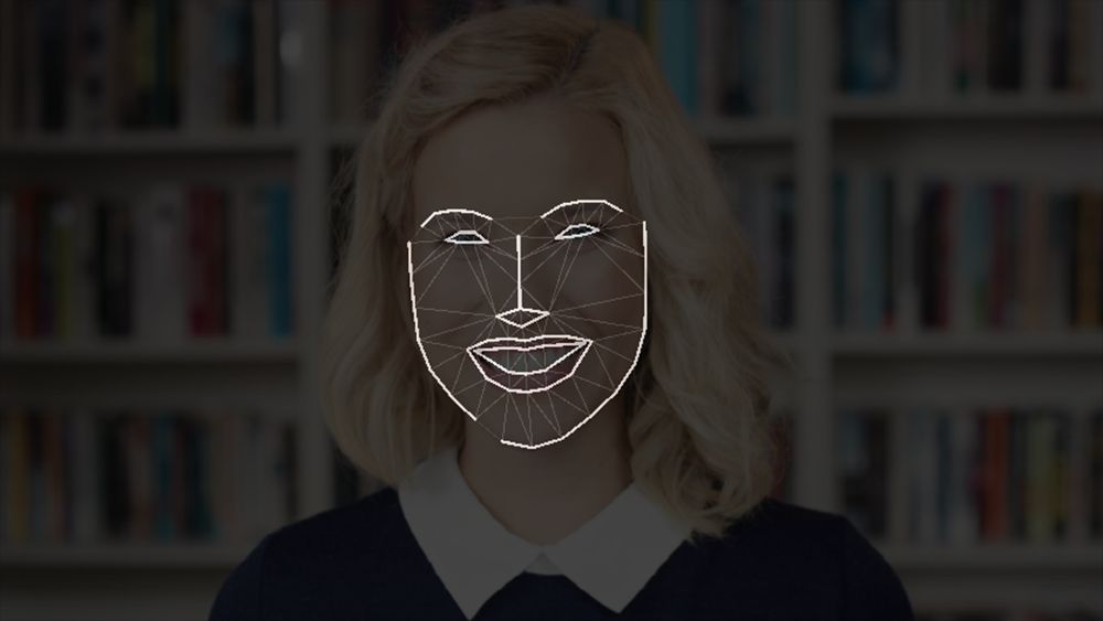

This node searches the supplied image or video for faces. If a face is found, a mesh is generated then tracked along with the image.
This node uses the NVIDIA RTX AI based face tracking solution to generate a face mesh, and track the points between frames. This features requires an NVIDIA RTX enabled graphics card, as well as the NVIDIA AR drivers (available here). Running on the GPU, this method is far faster than the CPU based alternative and can be used with a 3D Face mesh instead of a 2D mesh.

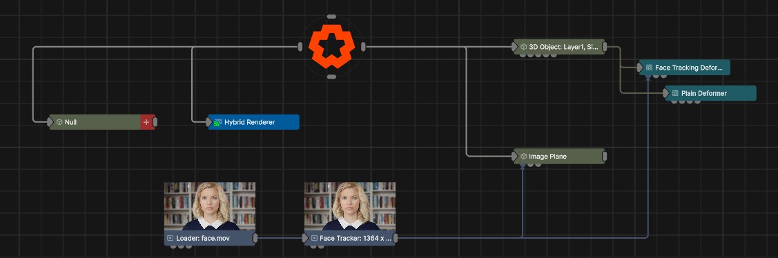

When the Face Tracking node finds a face it generates a mesh which may be used as geometry by the Face Tracking Mesh node, or used to deform a matching 3D object’s vertices using the Face Tracking Deformer node. The image output by the Face Tracking node can either pass through the original input; or output a mask from the detected face geometry in either the RGB or Alpha channels. Only one face can be detected at a time, so multi-face tracking is currently not supported.
The Face Tracker also analyses the detected face pose to determine whether the eyes and mouth are open, the positions of several key points such as the eyes, and the overall approximate rotation and scale of the face. These values are available as envelopes that can be extracted from the node via an Extractor and can, for example, be linked to Image 2D nodes in order to attach 2D images to points on the face. The Face Found envelope is set to 0 if no face is found, or 1 if there is.
