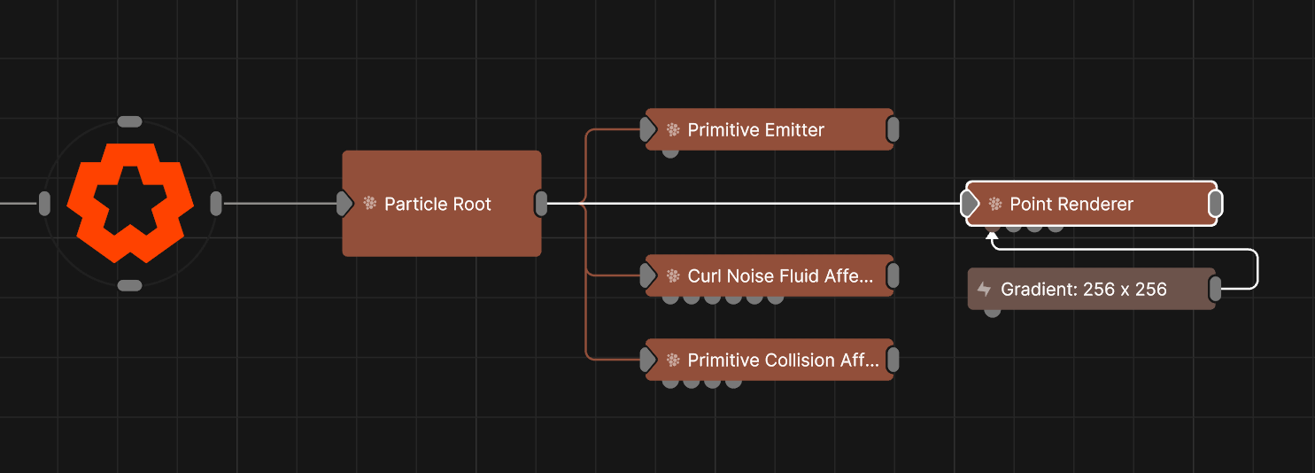

This node renders a point sprite for every particle. A point sprite is a plain rectangle which is positioned in 3D space, is rotated to face the camera and may be textured. This is the most commonly used rendering node for particle effects. An image or video may be used as a source for the sprite, set via the Texture parameter, or via a Video Node connected to the Image Node input. If an alpha channel is available, The alpha channel of the image is used to affect particle transparency.
Particles, like other 3D objects, are rendered to normalised viewport coordinates with sub-pixel accuracy. For some forms of output target such as low resolution LED screens it may be desirable to make particles fit exactly to pixels. The Pixel-Align Output control can be used to snap them to pixel boundaries and the size limits may optionally be specified in pixels.
