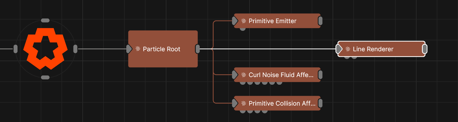

Renders lines between pairs of particles.
This node renders lines between particles and other points, which can be other particles or a set position in space.
