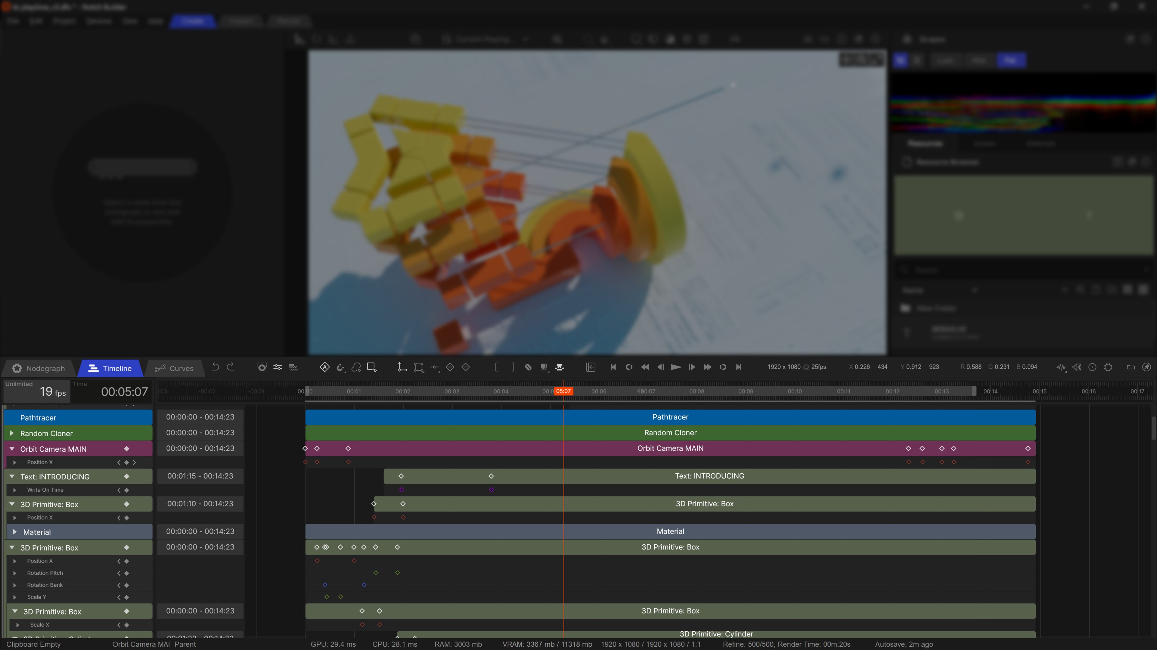

The timeline is the main view for cutting together and animating your effects. From here you can cut time segments, retime keyframes, and do basic curve editing.

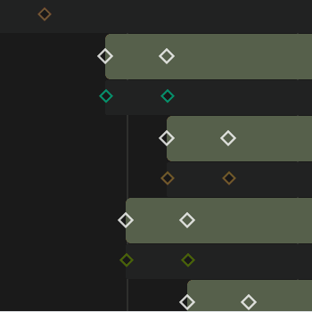

The move tool simply allows you to use the mouse to drag select and move time segments and keys in the frame.
Shortcut: X
move tool
icon Transform Tool #

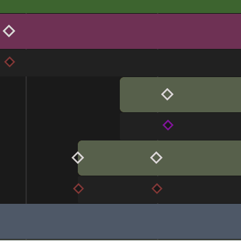

The Transform Tool allows you to adjust the timing of keyframe animations. Drag a region around the selected keys or time bars, and adjust the box size to re-time them.
Shortcut: V
move tool

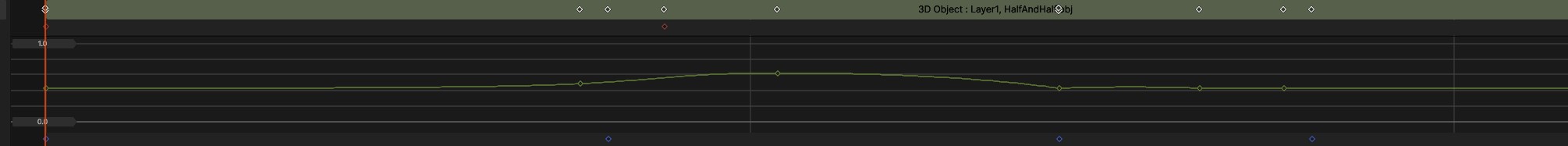

Mini Curves #
mini curves By expanding an individual properties keyframes, you gain access to smaller curve editor to the Timeline, so you can make quick changes to your keyframes without switching views.
