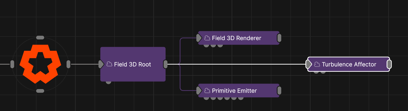

Turbulence Affector
Turbulence Affector
Applies turbulent velocities to a field.
This node applies turbulence to the movement vectors of a field system, applying a noisy motion with a large range of noise shapes.
