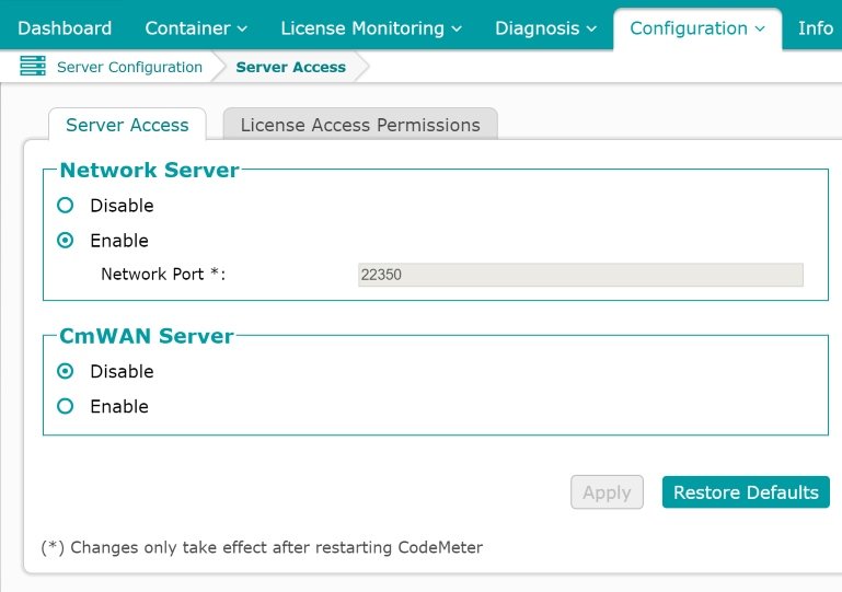

    1. Go to: File->WebAdmin
    2. In the Web Interface go to the menu: Configuration -> Server -> Server Access
    3. Enable ‘Network Server’ and keep the default port 22350
    4. Click Apply serversetup
