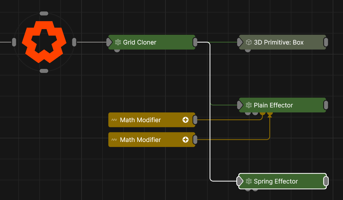

Modifies a cloner system by adding a springiness to clone transformations.
This node provides a springiness to clones by keeping track of their original positions before being effected and pulling them back into position.
Unlike other cloner nodes, this Effector is a simulation node. This means that jumping in time will not produce predictable results, as the simulation needs to process the frames in between.
Animation Rate How quickly the effector animates across the clones.
Spring Speed How quickly the clones are pulled back to their original positions.
Spring Dampening How much dampening is applied to the movements of the clones, so that they eventually slow to a stop.
Spring Mode The method by which the clone position to spring back from is determined.
  • Effectors In Chain : All clone effectors before the Spring Effector in the chain - anything moving the clone away from its initial position - determine the spring position.
  • Effector Children : Only effectors parented to the Spring Effector will determine the spring initial position.
