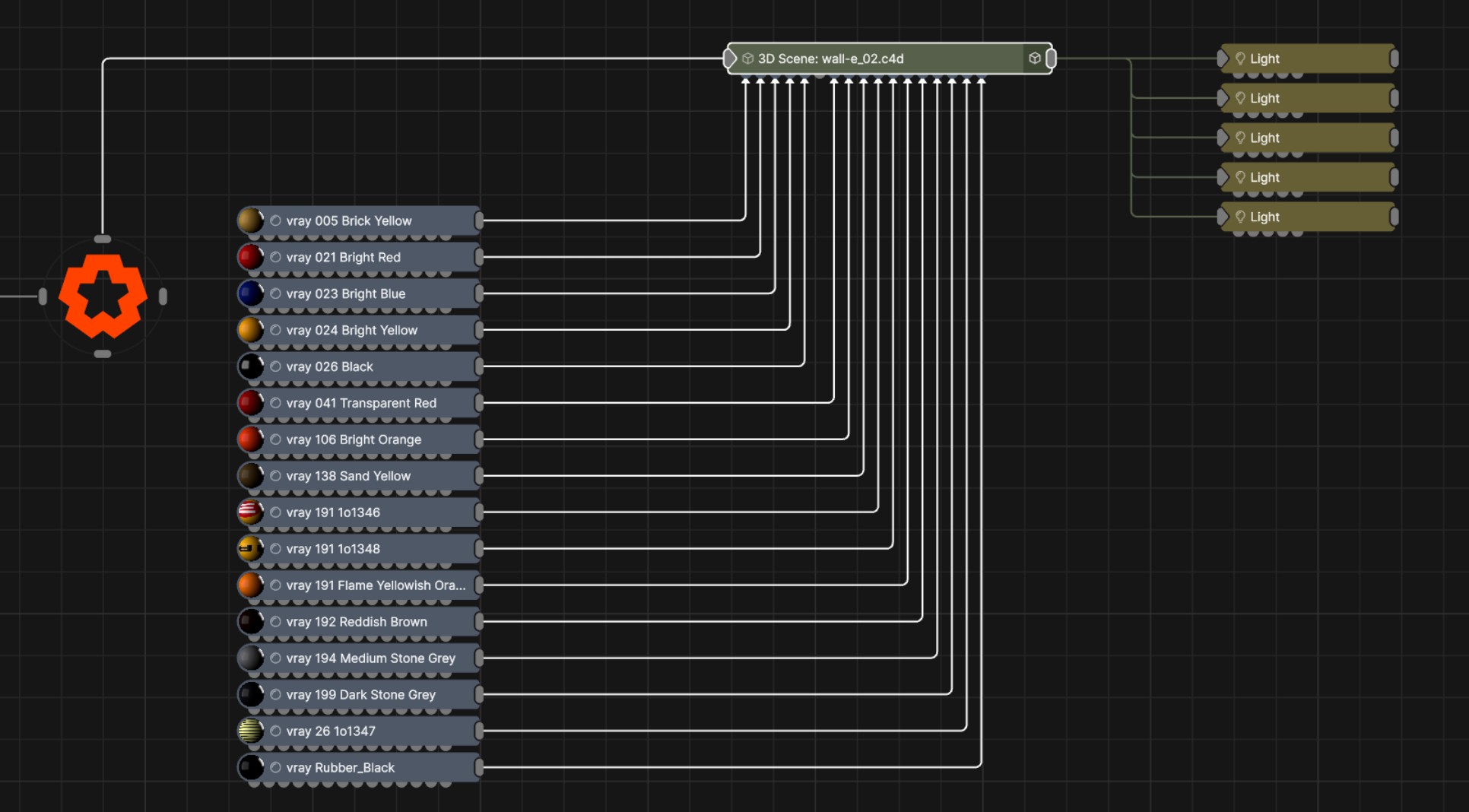

When a valid scene resource is set, sub-nodes are created for each node imported from the original scene - such as objects, lights, cameras, bones or transform nodes - and linked together as they appear in the original scene’s hierarchy. This allows complex scenes with skins, skeletons and hierarchical animation to work properly. These sub-nodes may not be deleted, their linkages may not be changed and some of their parameters, such as transforms, can not be edited - they are representations of elements loaded from the imported scene file. However other nodes from outside of the imported scene may be connected to them.

Use Cameras Use the cameras imported within the scene node as camera nodes in the scene.
Use Lights Use the Lights imported within the scene node as light nodes in the scene.

Convert To Editable Nodes Converts the entire scene to normal notch nodes, for easier editting and manipulating. Once converted to editable nodes, reloading the scene can cause problems to the node layout.
