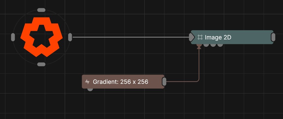

Generates a gradient image.
This node generates a gradient texture, with various modes and modifying properties.
