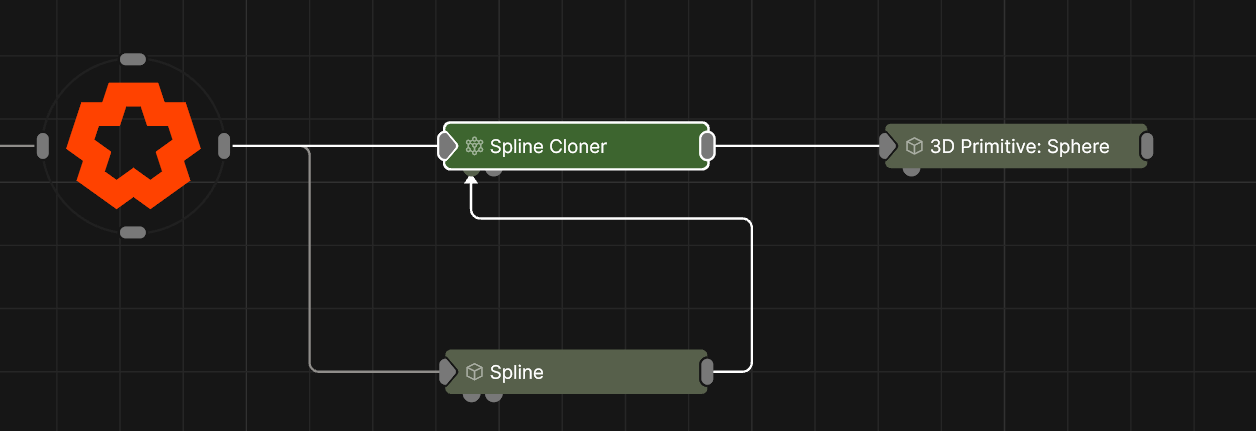

Generates clones which follow the curvature of a spline.
This node is used to clone objects along the spline created by an input Spline node or other source of spline data.

Source SplineSource Spline to generate clones from. A Spline must be connected for the cloner to generate clones.Spline
