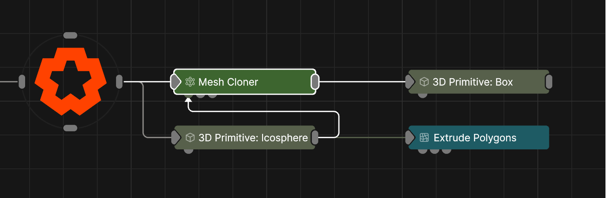

Generates clones from input geometry.
This node creates clones at positions defined by another 3D object. The connected node must generate a mesh, such as a 3D Object, a 3D Primitive or a Text node.

Source ObjectSource mesh from which all the clones will be generated.3D Object
WeightmapAdd a weightmap to vary the strength of the cloner across the surface.Generate Weightmap
