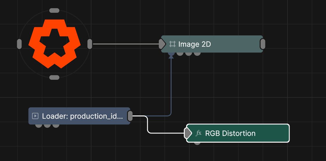

Add RGB sine distortion to an image.
This node applies multiple sine waves to distort the image, each corresponding to an RGB channel. The result is then further distorted with noise, to get a convincing distortion effect. Useful as a part of a digital glitch effect, simulating the RGB channels misaligning in a CRT display.
