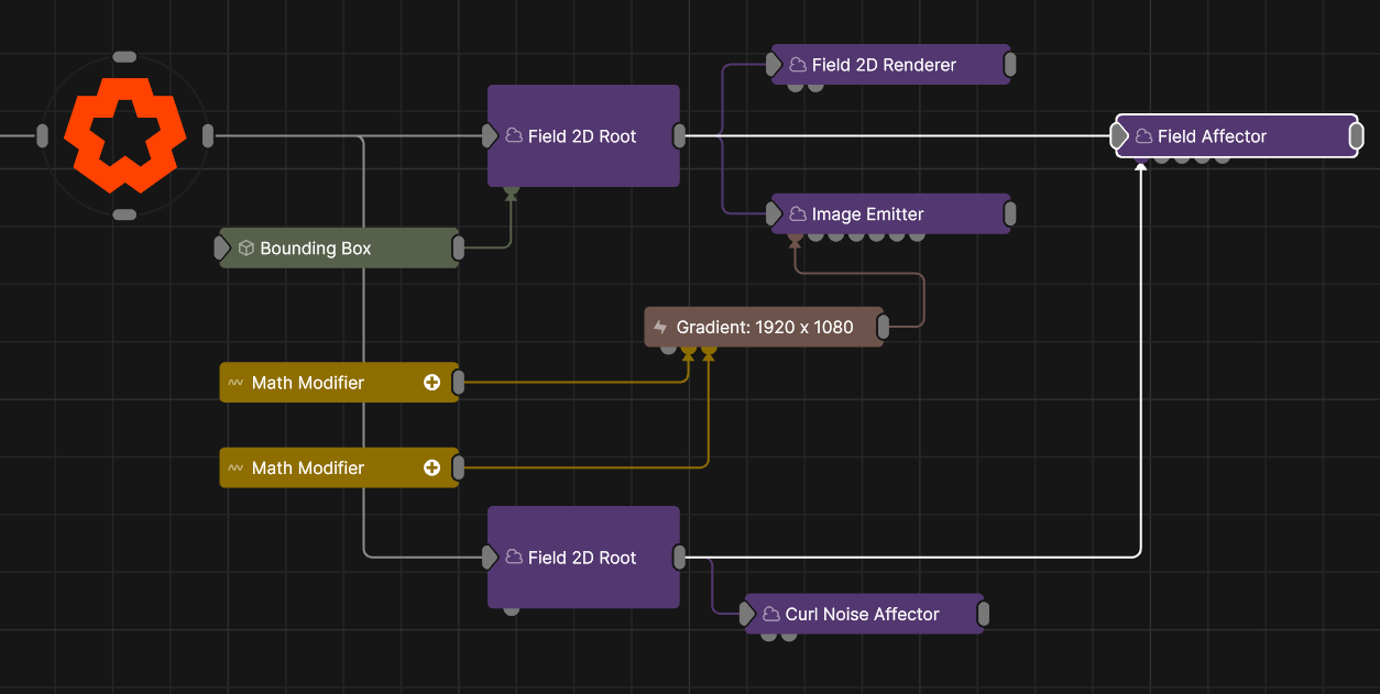

This node uses the velocities of a separate field system and applies them to the current field system. This allows for ink to be disturbed by the motion of air, without rendering the air itself. An Optical Flow node can also be connected in a 2D field system, to control the field from the motion of a video.

| Field Node | The field to be used by the affector. If no field is connected, this node will not function. | Field 2D Root |
