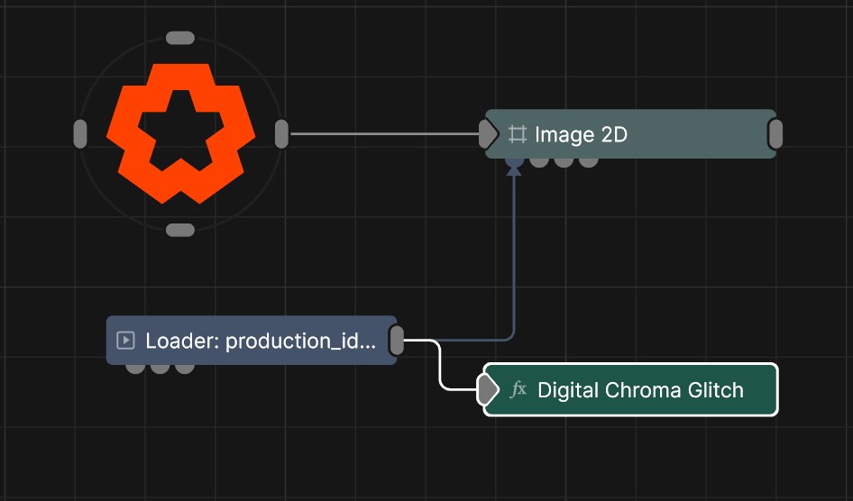

Chroma Glitch
Chroma Glitch
Add an animated colour glitch.
This node generates striped glitches which displace the image and alters its colours. Useful for quickly adding an image glitch which isn’t as intrusive as the Block Glitch, but still adds a nice glitch effect.
