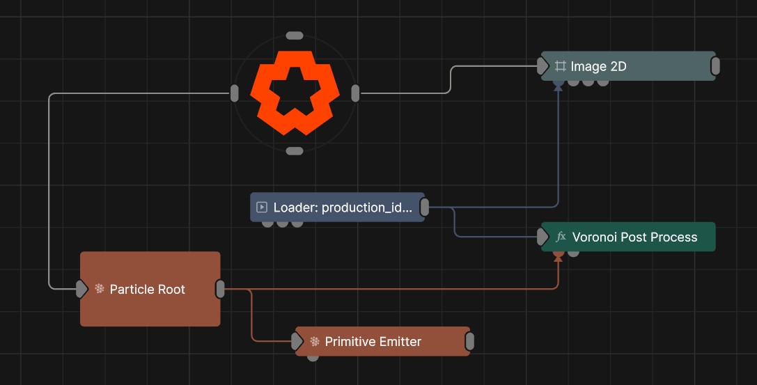

Add a Voronoi breakup effect to an image.
This node generates a Voronoi breakup of the image based on an input particle system, then applies an effect to the image by offsetting the image along a random vector.
Mode Changes how the voronoi diagram affects the image.
  • Reflection Warping : Use the voronoi triangles to simulate a glass-like reflection of the image.
  • Cell Colour : Sample a colour from the image for each triangle.
Warp Amount Changes how much the voronoi regions are displaced from the image.
Amount Changes how much the voronoi diagram affects the image.
Noise Distortion Distorts the output with noise.
Crack Amount How wide the cracks are between the voronoi regions.
Chromatic Aberration How much chromatic aberration affects the image.
Particle NodeThe particle root used to generate the distance field.Particle Root
Vignette NodeA solved vignette mask applied over the output.[Image]
