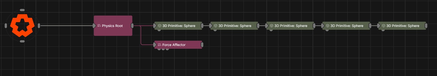

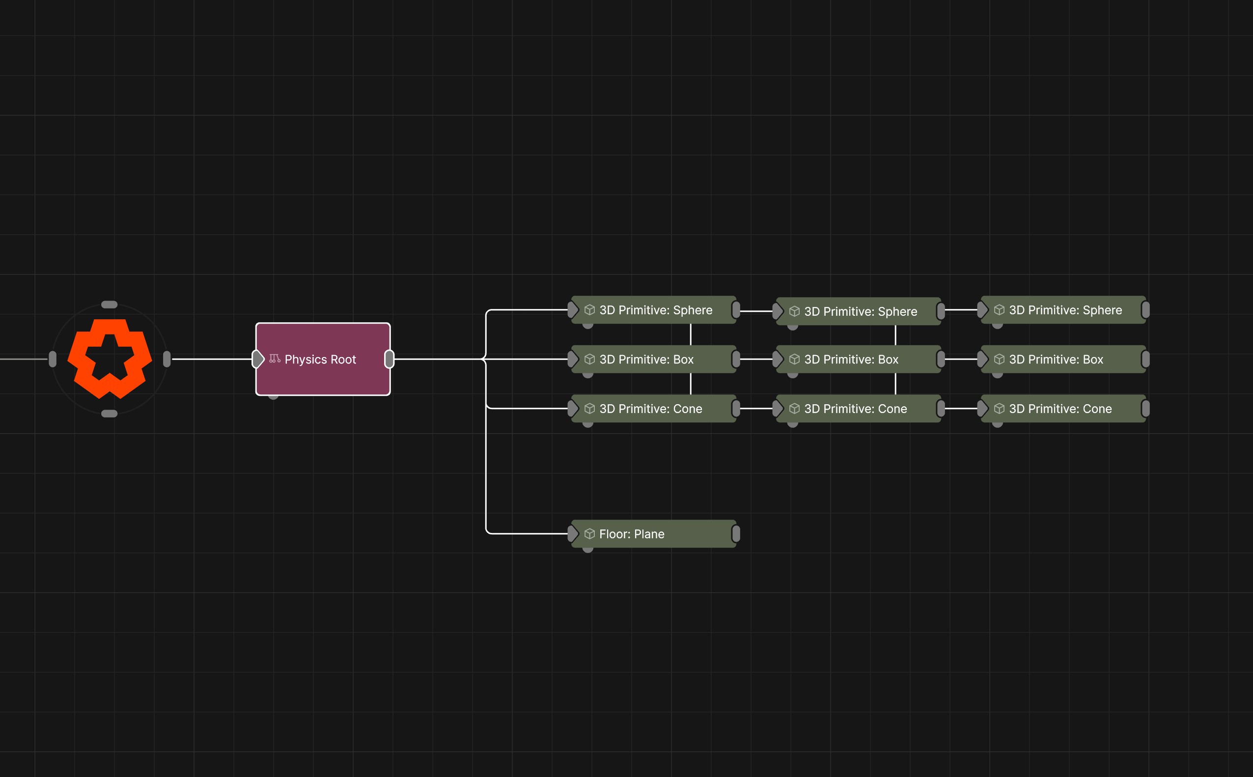

The Physics Root node is the root node of a rigid body physics system. Every node using physics that is parented directly or indirectly to a Physics Root node is part of the same physics system and will interact with each other. 3D Objects, Primitives, cloners with Rigid Body Effectors, and Rigid Body nodes may be part of physics systems and may interact with each other.

Floor Collisions Generates a default floor plane to collide all rigid bodies with.
Floor Height The height of the default floor plane.
