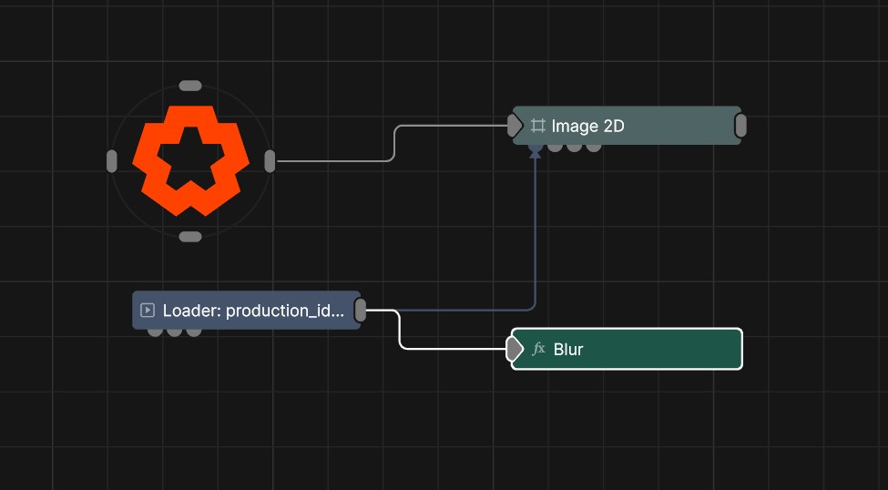

Add a simple blur effect to an image.
This node generates a simple blur effect by averaging the values of each pixels from their nearest pixel. This is a fast method, but it can require a large number of blur iterations for larger blur effects.
The node is also resolution dependant, so increasing or decreasing the resolution will change the perceived blur amount.
Iterations (Effect Size) How many iterations of the blur function are run.
Wrap X Does the blur wrap from on side of the canvas to the other on the X axis.
Wrap Y Does the blur wrap from on side of the canvas to the other on the Y axis.
