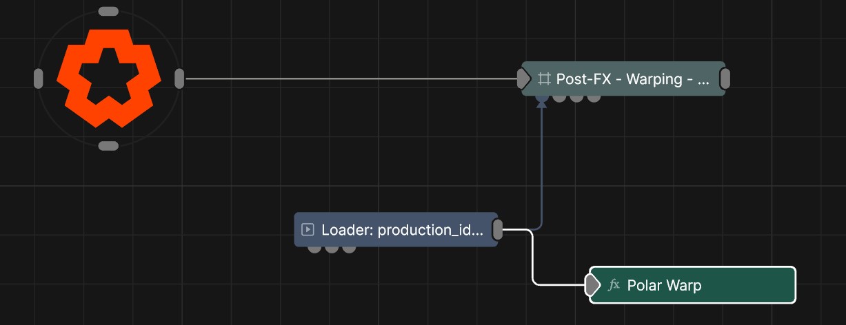

Warp the image using polar coordinates.
This node applies a warp to the image by using polar coordinates. The Tiles U/V parameters can be used to make the effect repeat.
Amount The amount the effect has on the image.
Centre X Change the centre X position of the effect.
Centre Y Change the centre Y position of the effect.
Tiles U The number of repetitions in u.
Tiles V The number of repetitions in v.
Texture Wrap Mode U Select how the effect should apply to the edges of the image.
  • Repeat : Effect will attempt to blend with the opposite side, to create a repeating effect.
  • Clamp : Effect will complete at the edge, with no attempt to wrap.
  • Border With Black : Effect will complete at the edge, then fill the remaining area with black.
  • Mirror : Effect will complete at the edge, and then mirror the effect again.
Texture Wrap Mode V Select how the effect should apply to the edges of the image.
This node has no inputs.
