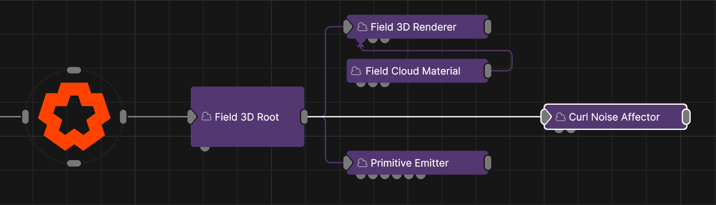

Applies curl noise velocities to a field.

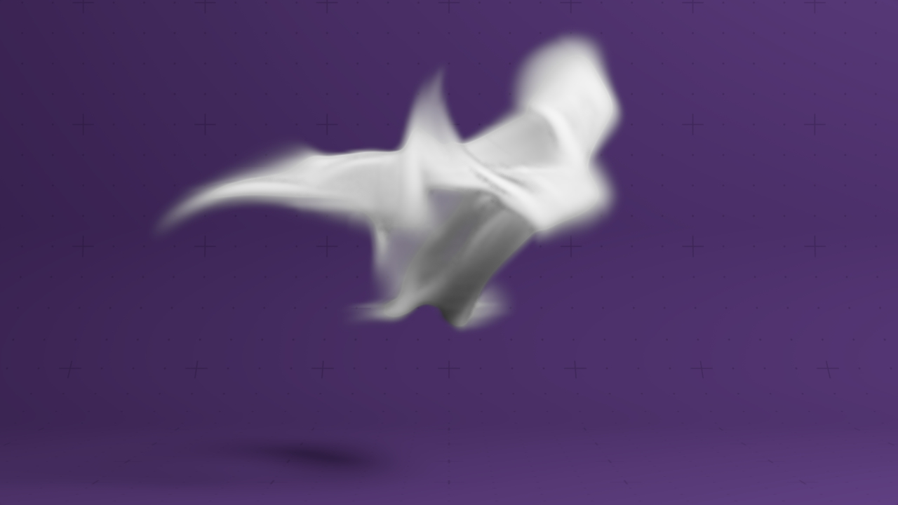

Applies a curl noise function to the movement vectors of a field, creating a random fluid motion.
Fluid Simulation Speed Controls the speed of the fluid simulation.
Curl Noise Amount The scale of the velocity being applied to the voxels in the field.
Noise Size Change the size of the generated curl noise.
Normalise Noise The curl noise size is normalised so that the vector velocities do not overlap with other voxels.
Perturbation TBC
Modulate By Velocity Is the curl noise amount affected by the velocity of the field.
Modulate By Temperature Is the curl noise amount affected by the temperature of the field.
Velocity TransformScale the resulting velocities from the curl noise to exaggerate along certain directions.Velocity Affector
