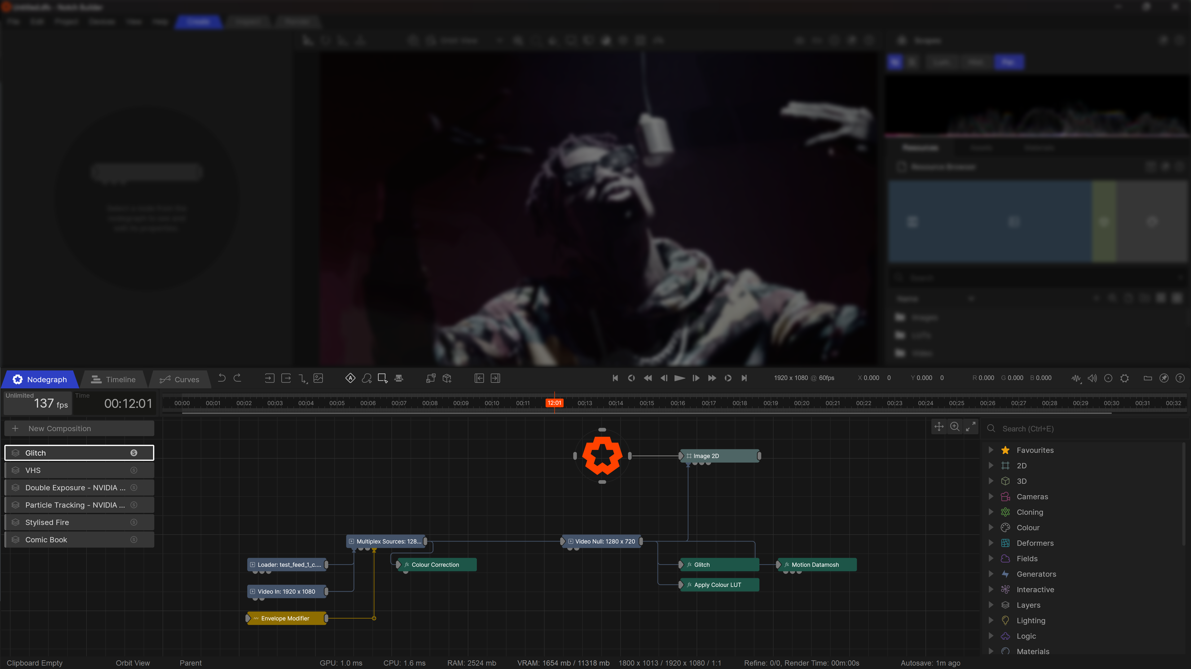

The Nodegraph is the main scene view for creating and combining the nodes in Notch. From here you can combine the different node systems together to create your render.
The Graph #
Where the magic happens. Every node which makes up your scene exists in this nodegraph.
The Nodegraph has a number of tools available to make putting nodes together as easy as possible.

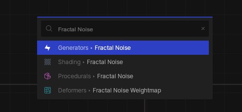

The floating search (Shortcut Ctrl+Space) allows you to search for any node in the node list, and add it into the Nodegraph. Double-clicking the left mouse button on empty space in the Nodegraph also opens the Floating Search panel for adding nodes.
floating search

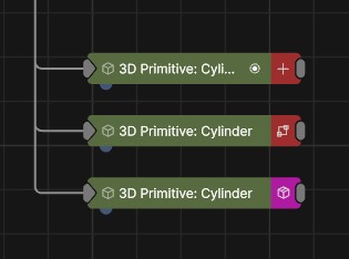

Embedded Nodes and Assets #
Nodes can be embedded into other nodes, for clean up or as a stepping stone in building assets. Hit the plus icon to expand and contract.
For more information on Embedded Nodes and assets, check out Assets and Embedded Nodes.

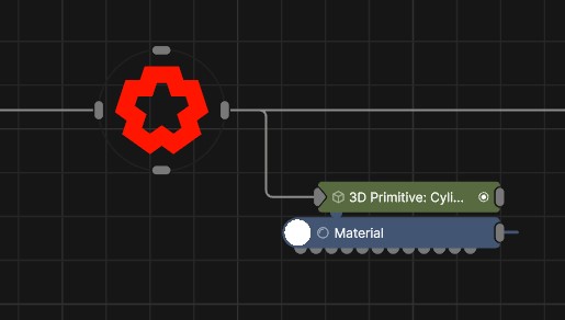

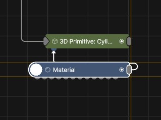

Active Nodes #
Nodes with a small broadcast icon are the active one of their group. This is usually applied to cameras and renderers, where multiple nodes can be in the nodegraph but only one is used.

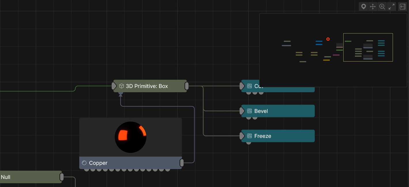

Minimap #
The minimap provides a compact, simplified overview of your nodegraph, displaying nodes without connections or labels. Click to pan, scroll to zoom, and right-click to access size and position presets or hide the minimap. The inner rectangle represents the viewing area of the larger nodegraph.
