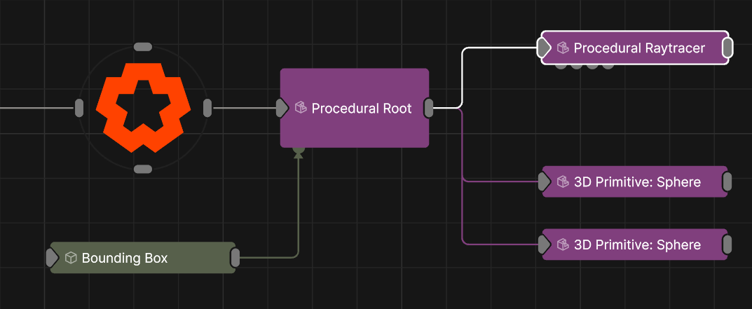

Renders a procedural system as a raytraced surface.
This node renders a procedural system as a raytraced surface using ray marching, allowing for significantly more detail and complexity to be rendered.
Ray Marching is a technique for rendering signed distance fields (SDFs) by drawing a ray from the camera and stepping through the SDF using the step size. If the distance to the closest surface (which easily calculable using an SDF) is lower than the step distance, then we know the surface has be hit and the system can be calculated. If the step size is too high, the ray can pass through surfaces it should hit, or hit surfaces it should miss. Lowering the step size can improve this, but can heavily impact perfomance. Complexity of the procedural system can also impact the surface detail, so simplifying the procedural where possible can also improve both accuracy and performance.
The Volumetric mode is a great way to generate clouds, and supports Field Materials.
Render Mode Control how the procedural is rendered after being traced.
  • Solid : The surface is treated as a solid surface.
  • Volumetric : The surface is treated as the boundary to a volume, such as a cloud or steam. Inside the volume, the further from the surface the ray travels the density increases. Useful for cloud and atmospheric effects.
Step Size How far the raytracer steps each iteration while finding the surface of the procedural.
Bounds Size Sets an outer bound for the volumetrics. Lower values can improve performance and limit the expansion of the procedural, while higher values may lose quality and impact performance - but allows for massive procedural systems to be rendered.
