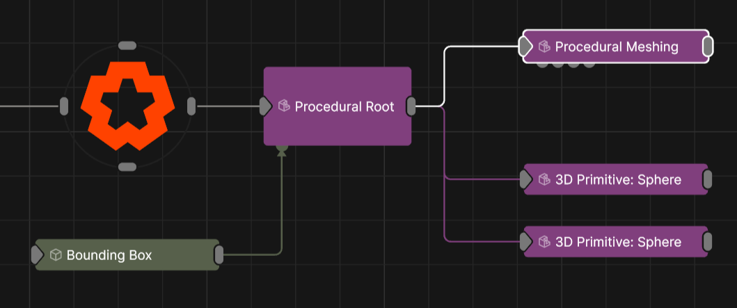

Renders a procedural system as geometry.
Generates a surface from a procedural by first voxelising it, and then constructing a smoothed surface over the voxels. The surface produced is a triangle mesh which can be textured, deformed, can cast shadows, and can be used as a particle emitter among other things.
Grid Width Width of the adaptive voxel grid.
Grid Height Height of the adaptive voxel grid.
Grid Depth Depth of the adaptive voxel grid.
Update Mode Set how the procedural system updates.
  • Real-Time Dynamic : The mesh will be dynamically re-generated on every frame.
  • Dynamic : The mesh will be dynamically re-generated.
  • Static : The last-generated mesh will be cached and re-used as a static output.
Error Tolerance If the procedural distance field has too much distortion then it may be necessary to raise the error tolerance. a higher error tolerance may reduce performance, so this is a trade-off.
Adaptive Subdivisions Amount of subdivisions to apply to the mesh.Can be used to smooth out the mesh.
Smoothing Iterations Iteratively smoothes the meshes vertices by the number of levels specified, averaging out all the vertices in the mesh and producing a smoother result. Smoothing is done before rendering. High values can impact performance greatly, and may not be temporally stable if the underlying mesh changes.
HQ Smoothing When enabled, vertex positions will be projected back on to the procedural surface. this preserves sharp edges without increasing the voxel grid size.
Distance Field Normals Vertex normals will be extracted from the procedural distance field. this can be more accurate, but slower.
Seal Boundaries When a procedural intersects the bounding box, usually a hole is created. enabling this option will fill in the hole.
Generate Colours Uses colours set in procedural nodes (such as 3d primitive) to colourise the generated vertices. this can reduce performance slightly.
Generate UVs Generate texture coordinates at the generated vertices, for use with a material. this can reduce performance slightly.
Show Metrics Displays information about the amount of mesh geometry being generated.
Procedural RootUse a Procedural Root as an input, so the renderer is treated separately from the roots transforms. In this case, the renderer itself would be connected to the scene Root node.Procedural Root
Render TransformTakes the transformation of another node and applies it to the rendered mesh.Null
MaterialA material to apply to the rendered meshMaterials
Bounding BoxThe region in which the surface will be voxelised and generatedBounding Box
