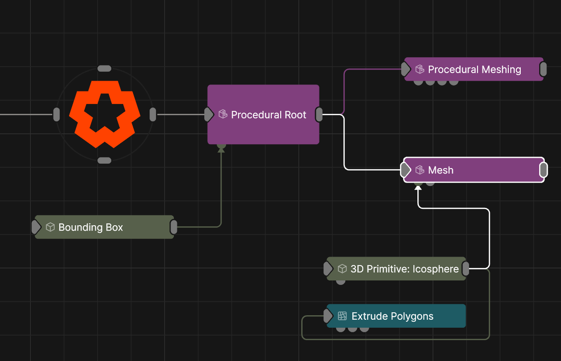

Generates a 3D Object for a procedural.
This node generates a distance field from a mesh object. Useful for converting a mesh into a procedural, as a basis for further processing.
Fill Mode Thickness of the Shell wall, when Filled Mode is set to Shell.
Shell Thickness Thickness of the Shell wall, when Filled Mode is set to Shell.
SDF Width Resolution of the distance field.
SDF Height Resolution of the distance field.
SDF Depth Resolution of the distance field.
Animate SDF When enabled, the procedural will be re-generated on every frame. use if the source mesh is animating.
Generate Colours Colours are generated for the procedural by sampling the first texture of the material assigned to the input object. this requires affect colour to be enabled and for the procedural renderer to support colour generation.
Generate UVs This feature is in development
Use Jump Flooding Uses a jump flooding algorithm to fill the sdf. Often times more accurate and temporally stable, but slow with animated meshes.
Object NodeMesh used for the generated procedural.ERROR: Variable not found: {input-node-particles-object-node-typical-input}
Bounds OverrideUsually the mesh object’s bounding box will be used for generating the procedural, but it can be over-ridden here.Bounding Box
