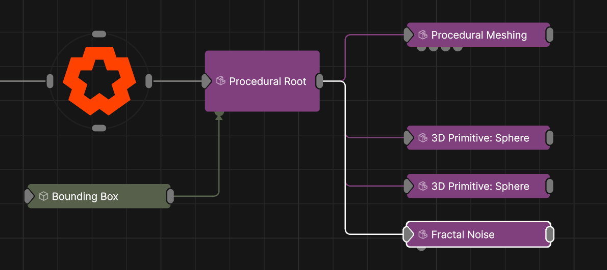

Generates 3D fractal noise for a Procedural system.
This node generates 3D fractal noise for a procedural system, useful for cutting into an existing shape with the CSG modes or generating randomised areas of falloff for a Cloning Effector.
